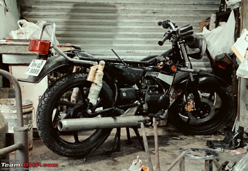

Current status of the RX:
Yamaha RX100: Retro-Modern modifications (back to stock)-picsart_080606.43.14.jpg

A couple of things which did not go as planned :
The rear mudguard could not be fitted because it was too too small and would pose a big problem during rains.
Fitting the original tail light and a plastic mudguard at the back instead of the chrome one. Don't want the headache of any parts rusting.
Half chain cover - Realised this will look better than the full chain cover. Will also mean that I will have to clean the chain regularly.
v12 is offline
