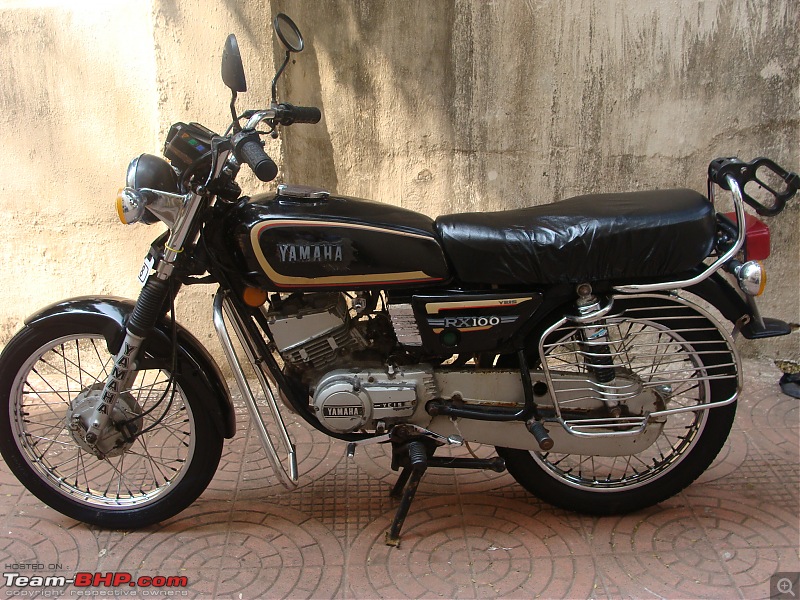

The bike when my friend bought it. Original condition. Single owner, original keys, all papers intact. The owner had preserved the original papers, invoice and the handbook as well.
Yamaha RX100: Retro-Modern modifications (back to stock)-psx_20160223_151928.jpg
Yamaha RX100: Retro-Modern modifications (back to stock)-psx_20160317_194251.jpg
Finally the bike comes to me this year.
Yamaha RX100: Retro-Modern modifications (back to stock)-picsart_052201.44.36.jpg
Yamaha RX100: Retro-Modern modifications (back to stock)-picsart_071704.12.11.jpg
The bike next to its elder brother.
Yamaha RX100: Retro-Modern modifications (back to stock)-picsart_022803.53.07.jpg
