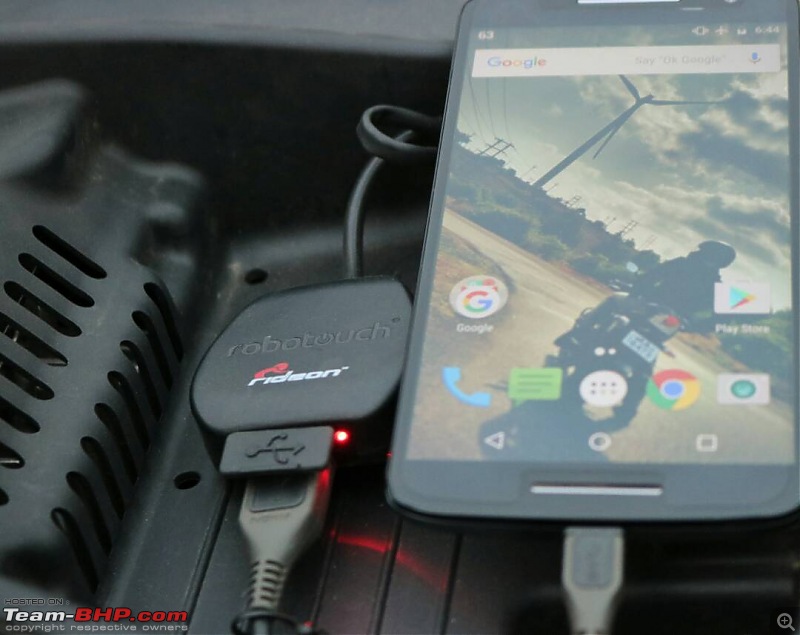

A mobile charging device is essential for those long rides & times when you are out the whole day. TVS provides mobile charging for the Fi model of RTR 200 but mine being the carburated version it misses out on that (Jupiter & scooty gets one!). My friend has a mobile holder with built in charging system but the charging rate/speed for that is really slow. So I thought for getting an independent charging unit (I already have a good waterproof/dustproof mobile holder). I saw this Robotouch mobile charging device on a Royal Enfield & the owner was very happy with it & said it was waterproof (later came to know that it is water resistant & can survive rains & bike wash), so thought of get one for me.
I have installed it under the rear seat as I don't want people to fiddle with it when I park the bike in public parking lots, however I do have the flexibility to re-route it on the handle bar.
My experience & observations:
1. Charging speed is good but do not expect the fast charging speeds of a fast charger like the turbo-charger (as Motorola calls) or Dash charger (from One plus).
2. The charger in my bike is always connected to battery & it turns ON only when any mobile/device is connected for charging (indicated by a red LED).
3. Charging speed depends upon the length & quality of the USB charging cable. At first I got a cheap & long USB cable & there was a noticeable drop in the charging rate. I wish the charger came with an USB cable.
4. Even with the charger permanently connected & the bike unused for 15-20 days the bike started with a single crank & the multimeter showed no drop in battery voltage.
5. It easily charges my powerbank & GoPro (with USB C cable).
