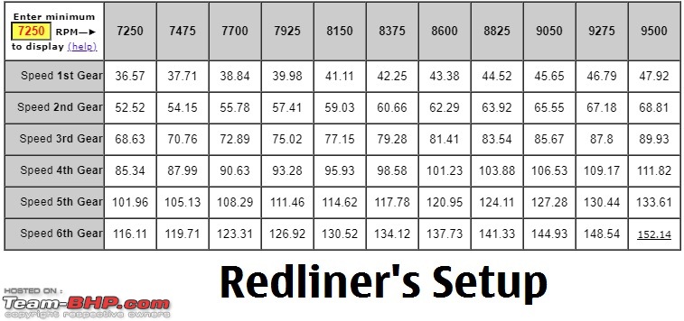

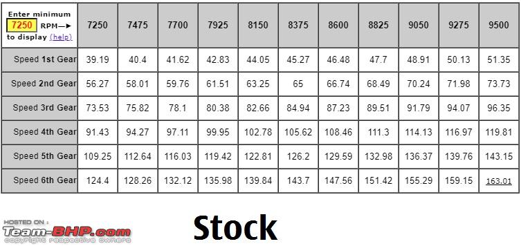

Originally Posted by Funny View Post
I was just wondering, what would be the outcome if both the changes are done together. That is, we change front to 14T and rear to rear+3T together, will that result in superb low end or a disaster?
Here are simulations for comparison, Cruising Speed(Peak Torque) is 7250RPM's and Top Speed(Peak Power) is 9500RPM's.
15/45
14/45
14/48

Old 2nd June 2020, 09:59   #209
Join Date: Sep 2013
Posts: 801
Thanked: 1,590 Times
re: The KTM 390 Adventure (Gen- 1) Ownership Thread!
Originally Posted by ashwinprakas View Post
Same Pinch!
Proceed with a pinch of salt as there is no torque or power to be made here. Only difference is gearing i.e in Redliner's case he has shortened his gearing i.e his engine has to turn more number of times to turn the rear wheel compared to stock i,e same speed at higher RPM i.e closer to power band i.e what is giving him the feeling of more torque.
A.P.
Ashwin,
You are partially correct in that there is no increase in torque. To be specific, there is no increase in engine torque. But changing the gearing in any way (inside the gearbox or the chain sprockets) does affect wheel power.
So shortening the gearing does increase wheel power at lower speeds as the engine is running faster and more power is made as the engine rpm increases. The added power at lower speeds increases acceleration.
Conversely, increasing the gearing for higher top speed may not work because engine rpm decreases for the same speed and there is less power at lower speeds. This is why many vehicles with over driven top gears achieve top speed in 1 gear lower.
Motard_Blr is offline   (5) Thanks
