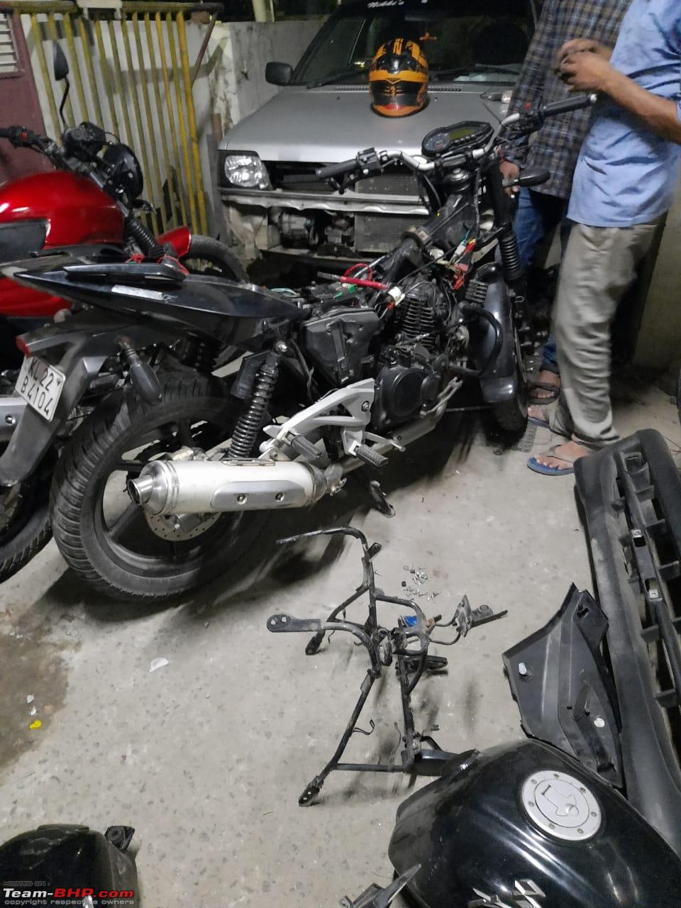

Re: KTM 390 Adventure India launch confirmed. Edit: Launched at 2.99 lakh.
Originally Posted by Red Liner View Post
Yeah man, i need to unhook the cables and check slack before ordering 2 inch risers. I feel two inch might be too tight a fit. Rox does not do 1 inch.
The clutch cable is more or less generic, I'm using TVS yoke and lever complete set with Bajaj cable so that is that. You could contemplate alternatives, the Avenger ones being the longest IIRC.
Only concern is the wiring harness and brake line, wiring usually extends to way over 2 inches if you undo the stays, in my P220 it extends well over 5 inches.
Finally comes the brake line, again you're at an advantage as its coming from the ABS unit and not the front rotor hence presents some leverage.
The KTM handlebar and holders are unique in the sense that they're tappered and thicker at the center, so the best bet would be to invest in a brand new handlebar or scrap the stock holder and get the Dominar(Visually identical mounting) holder as it accommodates regular bars, which would open up options for you to try.
Adapters and risers are simply not the right means to get the job done, especially since our market has a reputation of quality concerns when it comes to fasteners and irrespective of quality, leverage isn't your friend on a motorcycle ridden hard.
Here's a picture of the Dominar Holder with Himalayan bars in place, sorry for the picture quality;
The KTM 390 Adventure (Gen- 1) Ownership Thread!-whatsapp-image-20200228-12.26.56-pm.jpeg
The Dominar bar will give you some raise, the Himalayan bar would give you even more raise.
EAST OR WEST OEM FITMENT IS THE BEST! (Even if its from other manufacturers )
