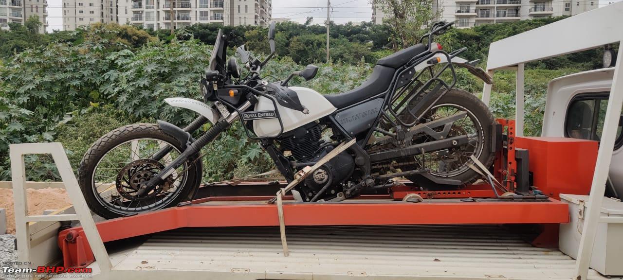

Chassis Snaps on a 2018 BS4 Himalayan
Chassis snaps on a Royal Enfield Himalayan | EDIT: RE to replace chassis & damaged parts for free-1.jpeg
This incident happened to an acquaintance from my Riding group. While Royal Enfield has agreed to replace the chassis, he has been asked to bear the labor charge of Rs 7,000. Some more damage was done to the bike while transporting the bike to the service center; the fuel tank and front mudguard got damaged. However, neither Royal Enfield nor the Service Center took responsibility for the transportation damage and blamed each other for it. They said they would check and try their best, but there has been no response from their end after that, and it has been almost a week since this incident occurred.
The owner uses the bike mainly for traveling from his hometown to Bangalore and back. He has hardly ever done offroading with it. He thanks his stars that the chassis snapped at a low speed, or the consequences would have been fatal. This incident and Royal Enfield's response have made him highly frustrated.

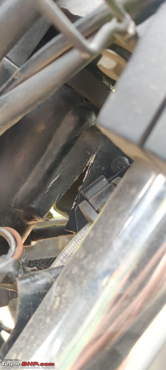

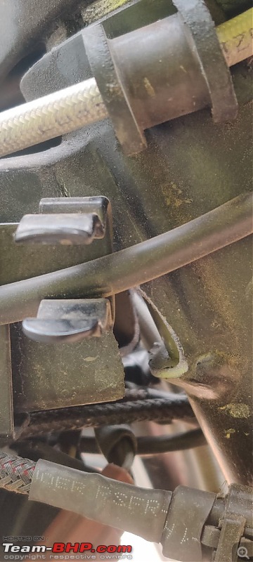

I own a 2018 BS4 Himalayan. On AUG 20th while riding at a speed of 30-40Kmph suddenly the chassis broke, and somehow I managed to stop the vehicle safely. Now the motorcycle is almost in two parts.
I took the delivery on OCT 31st 2018. After a year or so I started to notice the poor build quality of the motorcycle. It started with the detachment of the meter dial and is rattling like hell. The service center was not able to solve this problem. But even after all these, I continued with this motorcycle just because of the connection that I have with it. Today's incident really gave me a shock. I didn't expect the build quality of the motorcycle to be poor to this extend even after taking care of it well without even taking it off-roads often. I had really lost confidence in my motorcycle.
As soon as this happened, I contacted the Royal Enfield roadside assistance and booked their service for Aug 21st.
While transporting the vehicle to Koramangala Service Center, Some damages happened to my Himalayan. Now neither Royal Enfield nor the RSA is not taking responsibility for this damage. What they do best is blaming each other.
I sent an Email to Royal Enfield and till now I didn't get any response for that. All they want to do is just sell their Vehicles and not want to know what happens afterward

LoneTraveller, based on the facts that you have shared, it is pretty surprising to hear about Royal Enfield's lack of support on this issue. How many kilometers has the bike run so far? Has it been regularly serviced at the company SVCs?
Do ask your friend to take it up with the regional service head (contact details will be there in the Koramanagala SVC) and insist for a complete waiver of the fees. Considering that the additional damage was caused after the bike was loaded onto the company provided pick up truck, they (the company and / or the dealership and / or the RSA agency) should be bearing these costs, as well. Your friend should not have to pay one paisa from his pocket for these issues.
My Continental GT 535 developed a minor crack in the chassis (this is a known issue with the 535s, though it isnt widespread) and the company replaced the chassis and bore the cost of the labour. Here are some links that you can share with your friend to help in his discussion with the Royal Enfield team.
1. Chassis issue develops here
2. Waiver of chassis and labour costs here
3. Final bill details here
Hope better sense prevails at Royal Enfield and everything works out to the satisfaction of your friend. Ill ask the mods to move this to a new thread for maximum visibility.

The BS3 Himalayans were known for having welding issues that led to major problems for owners. We have a thread for that on the forum. To my (limited?) knowledge, these chassis problems were addressed in the BS4 versions and the BS6 versions seems to be the most well built and refined iterations of the platform. This incident is the first that I can recall hearing of a BS4 bike suffering this same welding related chassis cracking issue. It should never have happened but this does seem to be a one off.
I wouldnt go so far as to say that Royal Enfield still has a problem with chassis building. They have learnt their lessons and upped their game. The modern Himalayans (BS4 and BS6) are taking tons of abuse in the real world and so too are the Interceptors that are being used for touring around the country. I will be genuinely surprised if a BS6 Royal Enfield comes up with chassis issues based on just regular usage. So, I would suggest that we dont start worrying about our brand new Royal Enfields parked in the garage. A swallow does not a summer make.
What I find unacceptable though, based on the presented facts, is that the company and / or the dealership, asked the customer to pay for the labour. And to rub salt in the deep wounds, both didnt accept the further damage to the bike during transportation by the company provided RSA That is just amateur hour stuff and I know that Royal Enfield has built the processes to ensure that such nonsense doesnt occur.
If I were Lone Travellers friend, I would insist on
- The chassis being replaced with the same matching number as the original. If there has been any further reinforcements in the BS6 chassis, then he is likely to benefit from that as well, since he will get a brand new BS6 chassis.
- The damaged parts being replaced with new ones
- No payment for either of the above
Ive got my bike serviced at the Koramangala SVC and they seem to have sensible chaps there. That said, I would still take my bike to the company operated SVC by the Madiwala lake. All things considered, Im sure that the company will do the right thing and sort this out.
