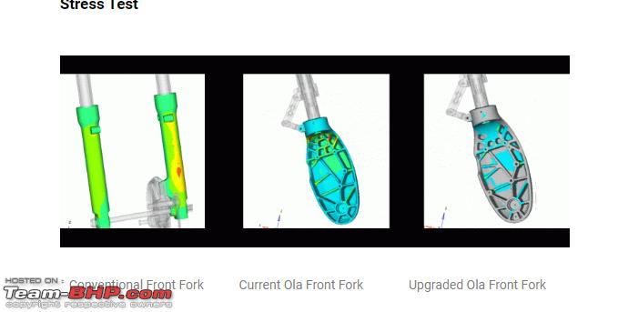

Any experts here have evaluated the new suspension setup and understood what is the update to suspension? Does it fully solve the issue?

So the blog does not give clear information on the boundary conditions of the simulations. From the gif of the simulation, it looks like they are giving the results in X-Z plane which can be considered the plane of the wheel.
The Y- axis which will be perpendicular to the plane has not been discussed. If anyone notices this will be the direction in which it will have more chance of failure because of it being a cantilever beam. The conventional forks will be much stiffer in this axis due to it becoming a rectangular section as the two shocks are held rigidly with the triple clamps and the front wheel axle bolt. As anyways those numbers are not given there is no point discussing this further.
Now coming back to the results shown in the blog post the new design seems to be stiffer in the x-y plane. If one notices carefully this is due to the material that is added back in the top region. Earlier it had cavities to save up on weight and material costs. The newer design seems to fill those up to reduce stress concentration in those areas. In the older design, you can see red areas which will generally mean that it has a high-stress concentration. As no index is given this is an assumption. They have also added stiffener ribs in other areas also to increase the sectional stiffness.
OLA S1: Front Suspension breakage issue!-zoom.png
One gripe I have is the new design starts with grey color and becomes blue while the older one starts with blue and shifts toward red in high-stress concentration areas. In the absence of an index, it is difficult to judge whether the same colors are used to indicate the same stress levels or not across the two designs. They should have been more thorough in regard to their engineering data presentation.
Now the new front fork seems to be stiffer than the older based on first principles thinking, whether it will be able to survive the harsh Indian road conditions only customer data will tell, and how thoroughly OLA has tested the new design during the validation period.
