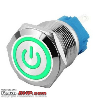

And the existing maddog switch will be replaced with a non-momentary circular switch, something like this (ordered one, but a wrong size)
Signal was tapped from the mobile charger socket as it was the nearest one and easy to tap without slicing / cutting any wires. Output snaps to follow shortly.
