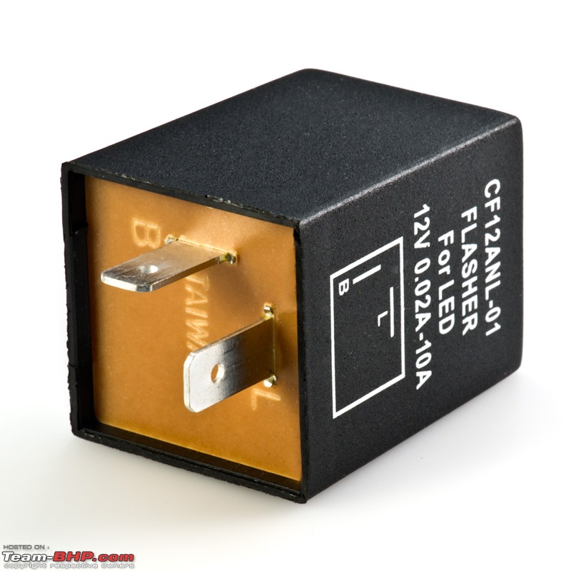

Originally Posted by outofthebox View Post
First I reduced the lighting load on the battery by about 30% by switching to LED lamps in brake lights, trafficators, pilot lamps, as well the LEDs in the console. I also tried a LED headlamp but the focus was not very good so I switched to Osram Night breakers.
Hi Can you please tell me if
-The replacements were just plug play or you had to do any changes to the holders or wiring
-In case of the trafficators did you have to introduce any resistors. I remember reading that since the wattage is low the trafficators blink rapidly and need resistors to be connected.
Thanks
Mate all the replacements are plug & play. They are identified by their holder type as follows: (Disclaimer: pls double check your bike's specific bulbs especially the console because there can be minor variations between different year RE models)
Tail Light: BAY15D
Pilot Lamp: BA9S
Trafficators: BA15S
Speedo Console: BA9S
As for the trafficator, yes resistors will work, but cleanest solution is to replace the 12V flasher unit itself.
The replacement part number is CF12ANL-01. A typical one looks something like this
(appearance & shape can vary between manufacturers)
Thanks a lot for the detailed and immediate response. The details are really helpful. This weekend I will check the type of holders and then order the lamps. It has been a while since I did any sort of DIY on my bike.
