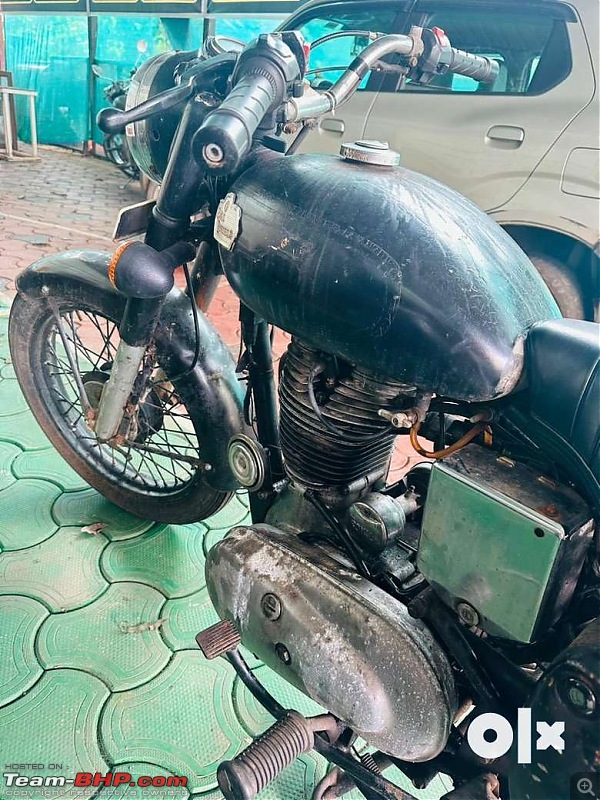

There is a Bullet 350 1980 model for sale in Goa. It's Delhi registered (so obviously expired RC). It's in fair condition. Owner claims that engine work is done but have to see the bike to find out. Cosmetically needs work.
He has quoted 50K but on DM said 35K final. Obviously thats too high for a non road legal bike which I'm going to keep as my collection and use only on internal private roads around my house.
How much to offer?

Not an expert!
But logic says - Vintage wise it would have value but a DL registration bike (even a maintained one) this old, is quite likely to have a lot of local parts. The paint and rust condition indicates no regular running so just to get it to appearance and running will need a couple of Ks.
35K for a regular bike is a steal if it is running, but better check the fuel oil consumption/leaks, which will give you some idea of the state of engine and tune. Also this being a RC expired bike and if you wish it to be road legal will require lot of work in papers and tax fines and a vintage expert may be able to guide you on that aspect.
You can check its scrap value in your area and go maybe 10-15k above using all the reasons above.
