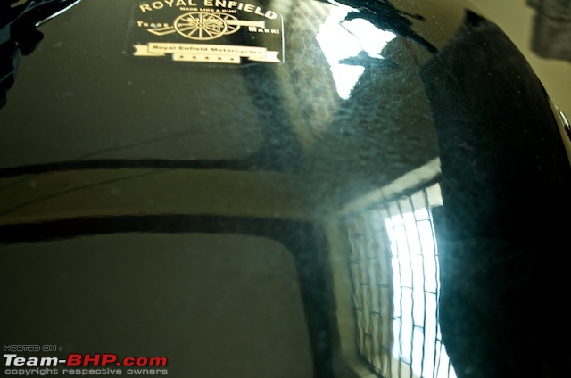

Another issue which i kept forgetting always is, The top of the fuel tank towards the seat has some kind of a paint finish issue, I had noticed it initially but it wasn't so bad, so ignored it, however it now looks like a sore point, Is it worth taking the bullet to the RE Dealer and asking for a finish repair or replacement? I personally would not be interested in a paint fix, Since i do not mind paying from my pocket and getting a better paint job done elsewhere than getting a buff or something from these guys at RE. Any advice on that?
I can live with that sore point though, it is just a little less shinier than the rest of the tank. Feels as if the sheen is gone, its a patch about the size of a tennis ball. Not exactly in the shape of a tennis ball though.
Which would be better? I am considering the following.
a) Ask RE to replace the tank with a new one. (Too much hassle and headache doing this, to get yet another mediocre tank from RE)
b) Get a paint buff job done at a workshop I know, who does a good job.
c) Get the tank re-painted at someplace like Dupont or elsewhere after doing some research.
I shall post pics of it first thing in the morning tomorrow.

From your description, I think it is only the clear coat on the tank that is affected.
IMHO, getting it repainted will result in a different color tone than the rest of the bike. Its hard to get it right. But this issue can be fixed with a coat of clear coat I guess. But do consult with a good painting shop first.

Also, I am not really keen to get the repaint done, I feel like getting a good paint repair done by a guy here, he is really good, and has done some paint repair jobs on my Swift with good results. I shall consult him first.
I am really not keen to check with the RE guys, they are useless and I know for a fact they will tell me it was my fault and i rubbed the tank against something to cause the dullness.

Here is a picture of the tank, with the problem area.
I went up to them with this issue on the 3rd day after getting the bullet and they said its not a crack and is just a little paint chip off.
