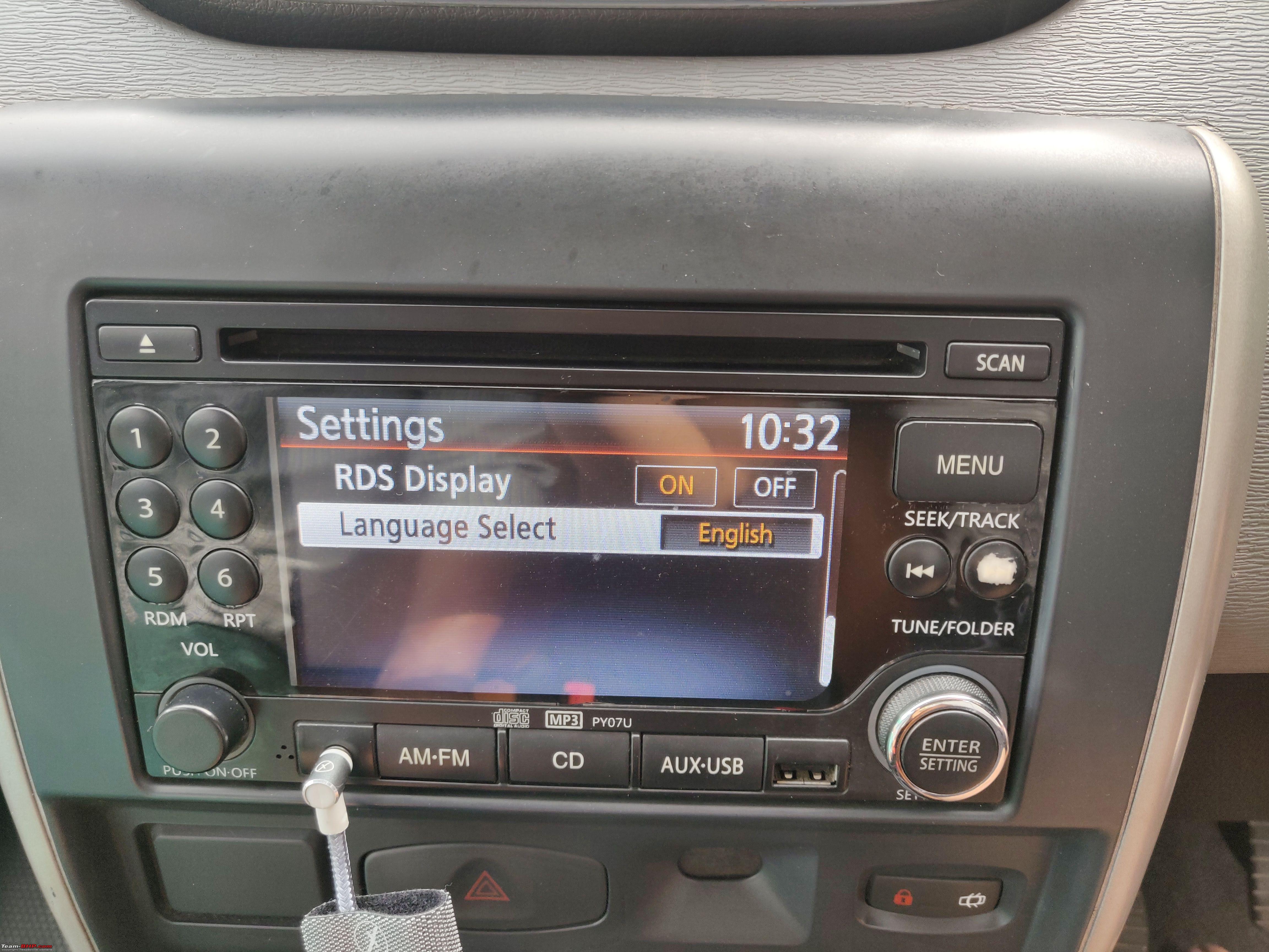

The most interesting thing was this stereo which came with the car. It is a Nissan Original Audio system which was found in some old Sentra models in the US. It is a non-touch display with the reverse camera option. Very strange as to how this audio set got here :Shockked:
