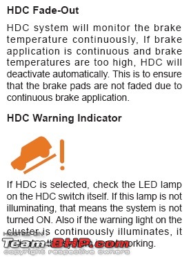

Originally Posted by sathya_nars (Post 3759274)
Wrt hill decent control, it should glow the yellow indicator on the dial (curvy road and car icon) when turned on.
That icon indicates activation of ESP.
2015 Mahindra XUV500 Facelift : Official Review-esp.jpg
When HDC is activated, the switch will illuminate.
2015 Mahindra XUV500 Facelift : Official Review-hdc.jpg
2015 Mahindra XUV500 Facelift : Official Review-hdc2.jpg
These are excerpts from the owner's manual of the old age XUV 500.

Hello, Sorry i missed your reply earlier. Yes pressing the start stop button once starts all the electronics and the battery icon shows up on the instrument cluster, But i am looking for the one hour mode in which there are no lights on the instrument cluster and infotainment system is on to use the music/ videos etc. If the car is running and i press the start/stop button once, The car shuts down completely.
Also about the HDC i cant see a message on the infotainment system as well but the light on the button does glow though. I think i need to get these things checked.
