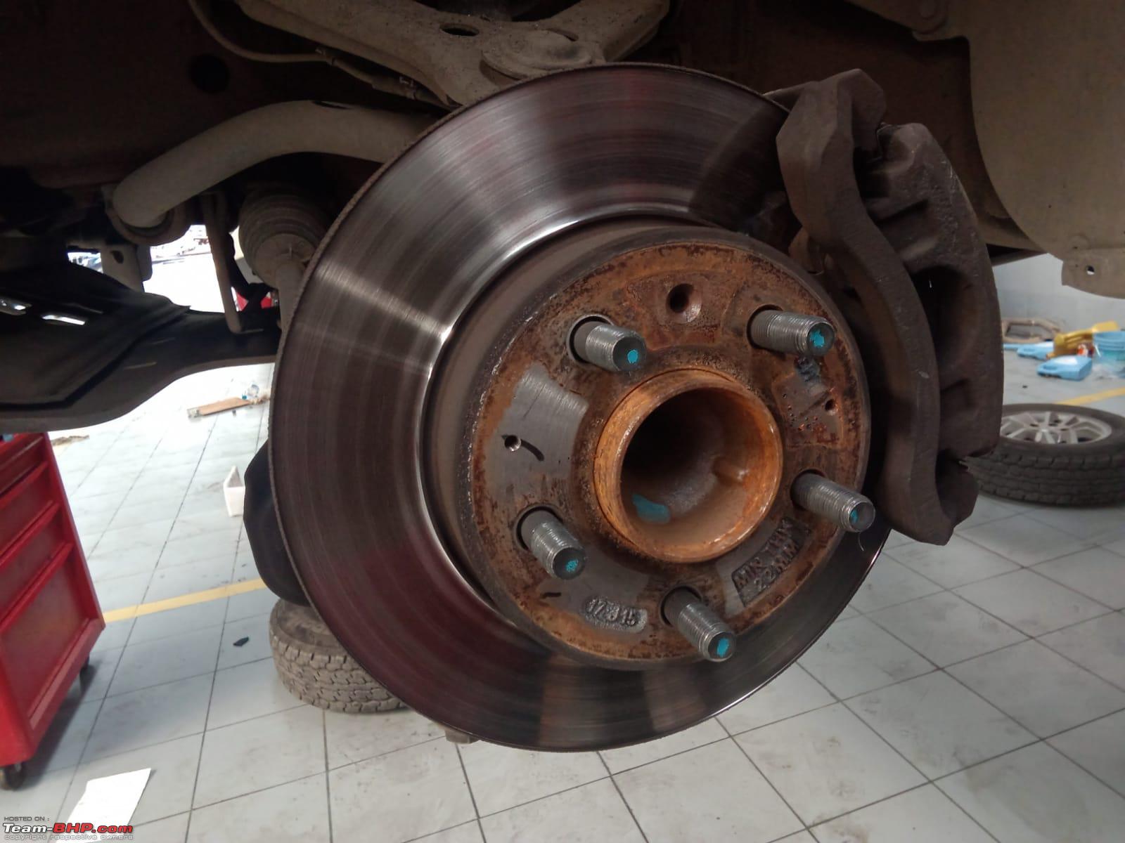

Need some expert advice over here. I have left my car for the 70K scheduled service as MASS in the morning. Just now received a call from my SA that the front brake rotor discs have completely worn out. Normally new disc thickness is 12mm and now both are at bare minimum of 5mm. Also, there are scoring marks. They cannot even skim the disc on lathe due to very low thickness left. Sharing the pics below. Each disc costs around Rs 2000/- and the brake pads around Rs 2600/-. Yes, they advised me to replace the brake pads as well. I had put a new set of brake pads during 50K service. So, the brake pads shouldn't have worn out that much, but they insisted to put a new set of brake pads on new discs. I want to ask the experts here if it is mandatory to put a new set of brake pads when replacing the discs. I have given them the go ahead to replace the brake discs and brake pads. Yet I want to check with experts here if I have made the right decision
Mahindra TUV300 : Official Review-lhs-rotor-disc.jpeg
Mahindra TUV300 : Official Review-rhs-rotor-disc.jpeg
