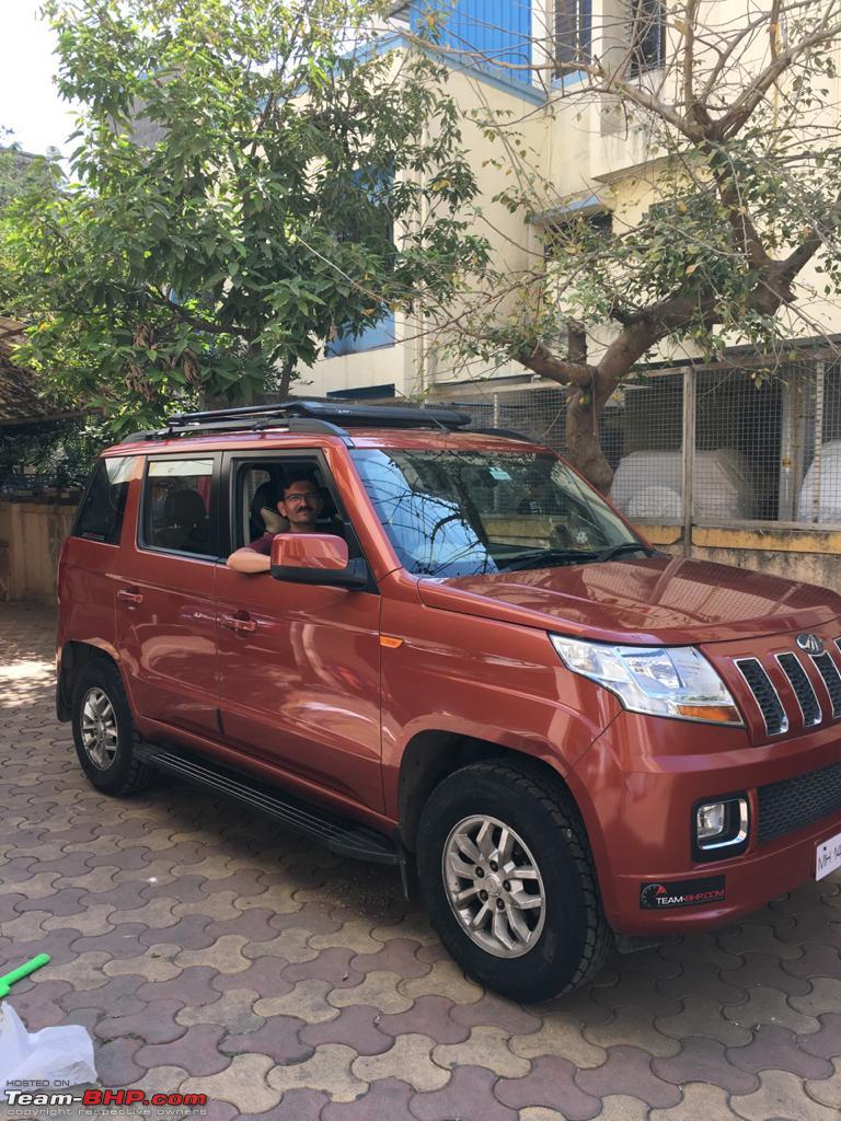

Today morning went to the Tyre Shop, Balaji Tyres on Tata Motors road and got the 4 tyres replaced. Fitted the Apollo Apterra HT (same as stock tyres) for Rs 6100/- per piece. The dealer bought back the old tyres for Rs 400/- per tyre. So net effective price per tyre for me was Rs 5700/-. Fortunately all the 4 tyres had "0422" embossed for the date. This means each tyre manufactured in the 4th week of 2022, fresh from the factory. The dealer told me that these were billed from the company just a day ago. So I was very luck to get the latest manufactured tyre.
The wheel balancing was done for all 4 tyres and later the wheel alignment was also checked, all free of cost. Right from handing over the car to the billing, everything was done in 30 mins flat as promised. Luckily I was the first customer in the shop today morning, so it was a quick affair. I was very happy to get Rs 400/- per tyre for the old tyres, didn't negotiate much. These were 6 years and 3 months old and run 58K kms. The spare tyre was found to be in good condition, so didn't replace that. It will be used sparingly, only in case of any emergency. The rotation will be done within the 4 new tyres. The new tyres have 3 years warranty. The shop person advised to get the wheel alignment and balancing checked every 5K kms. To be honest I never checked the balancing and wheel alignment was checked once in 10K kms.
I am fond of these Apollo Apterra HT tyres. The stock ones never gave me any problem and had only 2 punctures in the last 6.3 years (touchwood). I asked for Bridgestones as well, but the shop person told me that the Apollos are best suited for TUV, whereas the Bridgestones are more suitable for the Scorpio. Below is the pic of my tank on new shoes. I would highly recommend this shop, Balaji Tyres for all those staying in Pimpri-Chincnwad, Pune area, very professional and lowest tyre pricing in this area.
