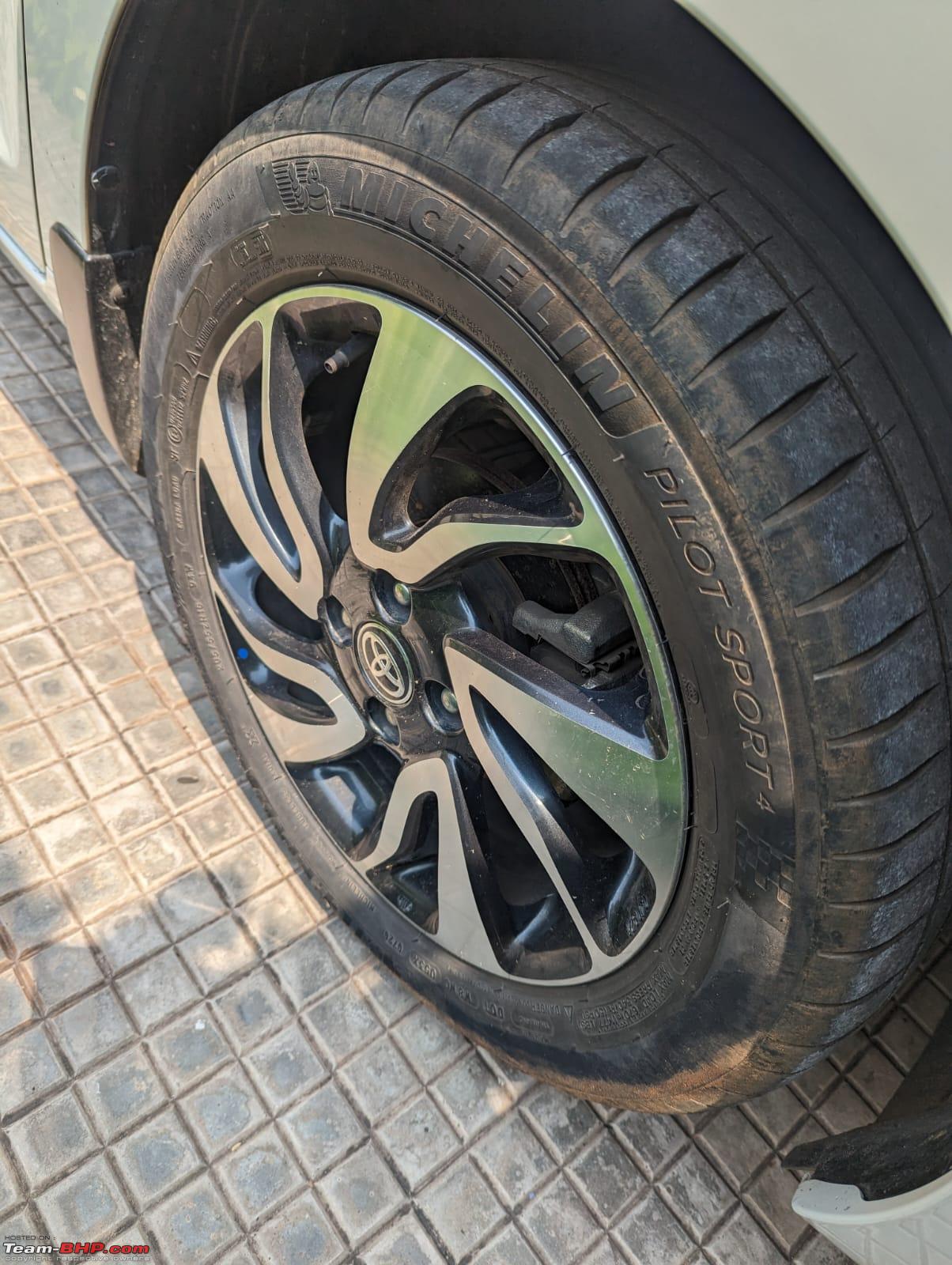

Actual Fuel efficiency with a CVT gearbox?
I have a 2020 Toyota Glanza-V CVT, done 21,000kms and off-late, driven 99% in city traffic only. It is a nice, spacious car with supportive and comfortable front seats.
Modifications done are:
1. under seat active Subwoofer
2. sound damping on all doors and boot-lid
3. upgraded the tyres on day-1 of purchase to Michelin Pilot Sport4 205/55 ZR16.
It drives reasonably well within the city limits but not exactly relaxing on the highway runs. Overtaking or increasing the speed after a slow down is a noisy and sluggish affair resulting in a delayed momentum. The 'S-mode' be dammed - just adding to the frustration :mad:
The engine/cvt/car, somehow feels far from being peppy and is frustrating when trying to speed up in traffic and highway, with the rpm needle moving very briskly without any increased momentum of the car. I know it is the rubber-band effect of the CVT but still, is it that bad?
The actual fuel efficiency is around 17+ kmpl on highways and a mere 8-9 kmpl in city :unhappy
A friend, who is tyre dealer/retailer says that, the main culprit for the low pick-up and fuel efficiency are the 205/55 ZR 16 tyres. He says these tyres are actually dragging the car.
Recently, "test drove" a Suzuki Wagon-R 1.2NA manual, and boy, it was peppy. Wrong comparison but such a vast difference, because of a different gearbox and bodyshell?
So what's wrong with my car? Need your inputs here people. Is my tyre shop friend right about my tyres?
PS: Mods, posting about the Glanza CVT in the Baleno thread, hope it is fine, otherwise please move it to an appropriate thread.
Maruti Baleno : Official Review-tyre.jpeg
Hey mate, I've a Delta 2020CVT.
I've upgraded from 185/65/15 to 195/60/15
The mileage is 14 in the city and around 19 on highways.
The rubber band effect will be there, i feel the tyres are slowing you down a bit. I suggest a test drive of a CVT Baleno on stock tyres and seeing if that feels any different and if it is worth changing the tyres. Look up spinny etc for test drives.
Good luck!
Michelin Pilot Sport4 205/55 ZR16[/u].

Same use case. 2017 Baleno Alpha CVT with Michelin Primacy 205. The ride and lateral grip during turns is much improved and mileage has not suffered negligibly - 12.5/13+ in daily peak hour commute.
No two ways about it, the CVT is not meant for spirited driving. Try doing the 'double acceleration' trick to reduce the rubber band effect - 1) Bury the throttle fully for 5 seconds 2) Let off the accelerator completely 3) Step on gently to the accelerator and gradually start flooring.
That's an awesome mileage for city drives. Maybe I should review my current driving style.
Will try and do that mate, thanks!
Originally Posted by d_himan (Post 5551304)
Same use case. 2017 Baleno Alpha CVT with Michelin Primacy 205.....mileage has not suffered negligibly - 12.5/13+ in daily peak hour commute.
Very good to know, that even with 205s tyres, good mileage can be achieved, and I seriously need to look into my current driving style.
I will try this method, thank you for the tip!
Also, I did increase the tyre pressure to 34-35psi and there is a slight increase in pick-up but nothing in the fuel efficiency part.
I am actually on the verge of selling this car and preponing my EV purchase by getting the Tiago EV asap. Currently I am spending INR 3500/- on 32litres of regular petrol at INR 110.46/L and getting a combined range of a 300-330kms:Frustrati
