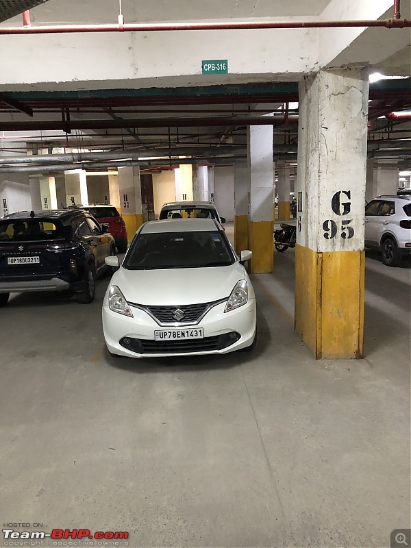

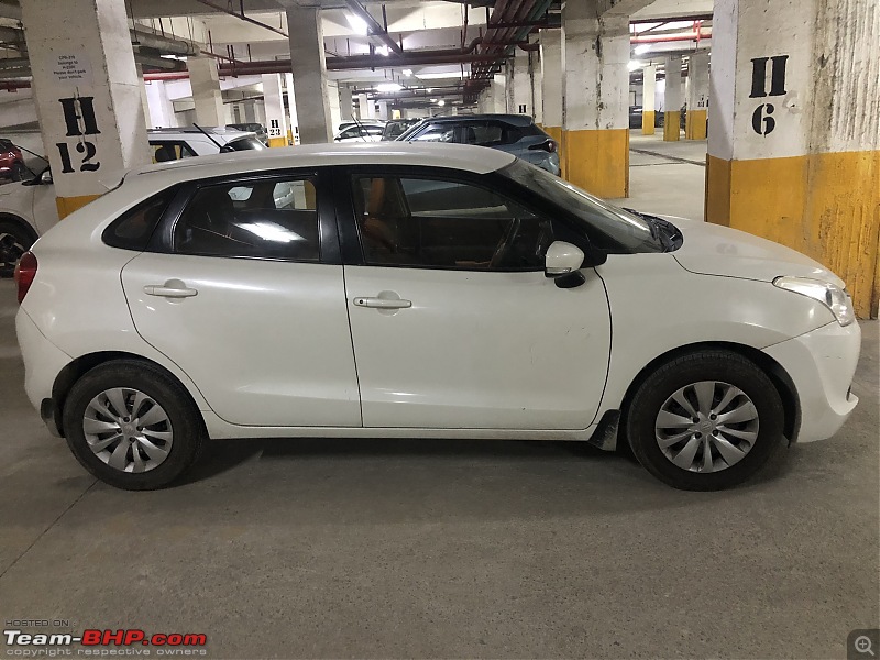

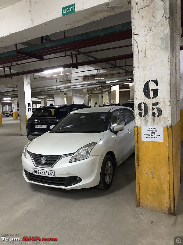

My 2016 Baleno Delta 1.2P ran 95000 kms flawlessly with service from MASS and then Nexa Service, I always asked them to use mineral oil and replace other items as per service manual. I never added/installed any performance booster part or anything except Bosch Brake shoe at 85k kms and Adon P available at petrol bunks once or twice.

Handing over in Dec'23 to Spinny
