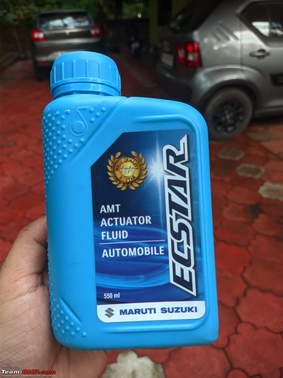

All the threads with AMT failures have begun to give me nightmares and I've decided to do the bare minimum in preventive maintenance. The actuator fluid has never been changed in my 5.5 year old 32k km driven car. So I got a can from boodmo and will be replacing the same over the weekend. More details can be seen in these posts from d-bhpian audioholic.

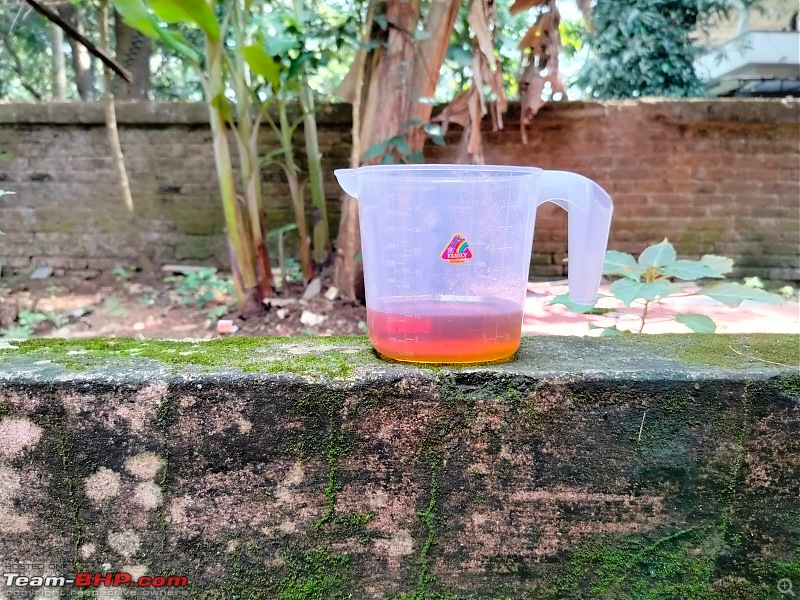

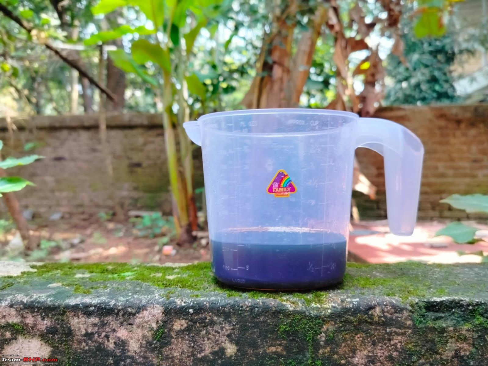

An update on the fluid change.
Followed the steps in the post by @audioholic. You can see the state of the old fluid. I could only extract about 210ml using the syringe. It is only about half of the reservoir capacity. Will be repeating the procedure after a couple hundred km. I've decided to change the fluid after every 15k km. Hope this will help in prolonging the life of the system.
