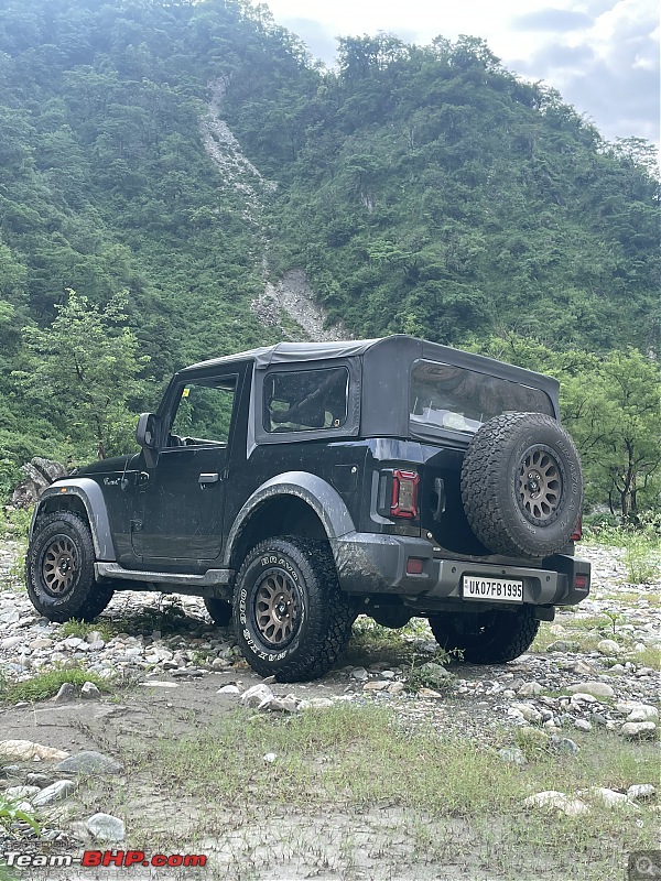

I have upgraded to 16 inch alloys on my Thar with 275/70 R16 Maxxis AT 980 tyres. They have been great, no fouling with suspension components, no change in over size as compared to stock setup and also they have improved the ride quality. They also fill up the wheel wells pretty nice.
Here are some pictures for reference.

They look nice and it is great that they have helped improve the ride quality. Has there been any impact on fuel consumption?

The wheels look really great. From the looks of it they have negative offset compared to the stock rims, I guess that would completely eliminate any possibilities of the tyre fouling.
Adding on the question above about fuel economy, how has the impact been on steering feedback due to the increased contact area ?
Also, when you say the ride quality is better, is it more supple over the smaller road imperfections ?
Thank you for the kind words.
There has been negligible difference in the efficiency. City traffic gets me around 11 to 11.5 kmpl and on the highway around 13.5 to 14 kmpl. If I drive a bit conservatively on the highway then I have achieved a bit north of 15.5 kms to the litre. My jeep is a Diesel AT and also the city efficiency is for Dehradun that does not have a lot of traffic as metros but has hills around.
Since the overall diameter of the alloy+tyre is almost the same as the stock setup, they do not even foul with the front bumper on full lock.
The steering wheel has definitely become heavy but I got used to it very quickly, that could also be due to the fact that I have driven a Hexa in the city for good amount of time. After the Thar whenever I drive our other car, a S-cross, the steering on that feels like a toy.
The ride is less bouncy now on the imperfections and higher side wall takes away the sharp bump from the pot holes. So overall an upgrade as compared to the stock setup.
