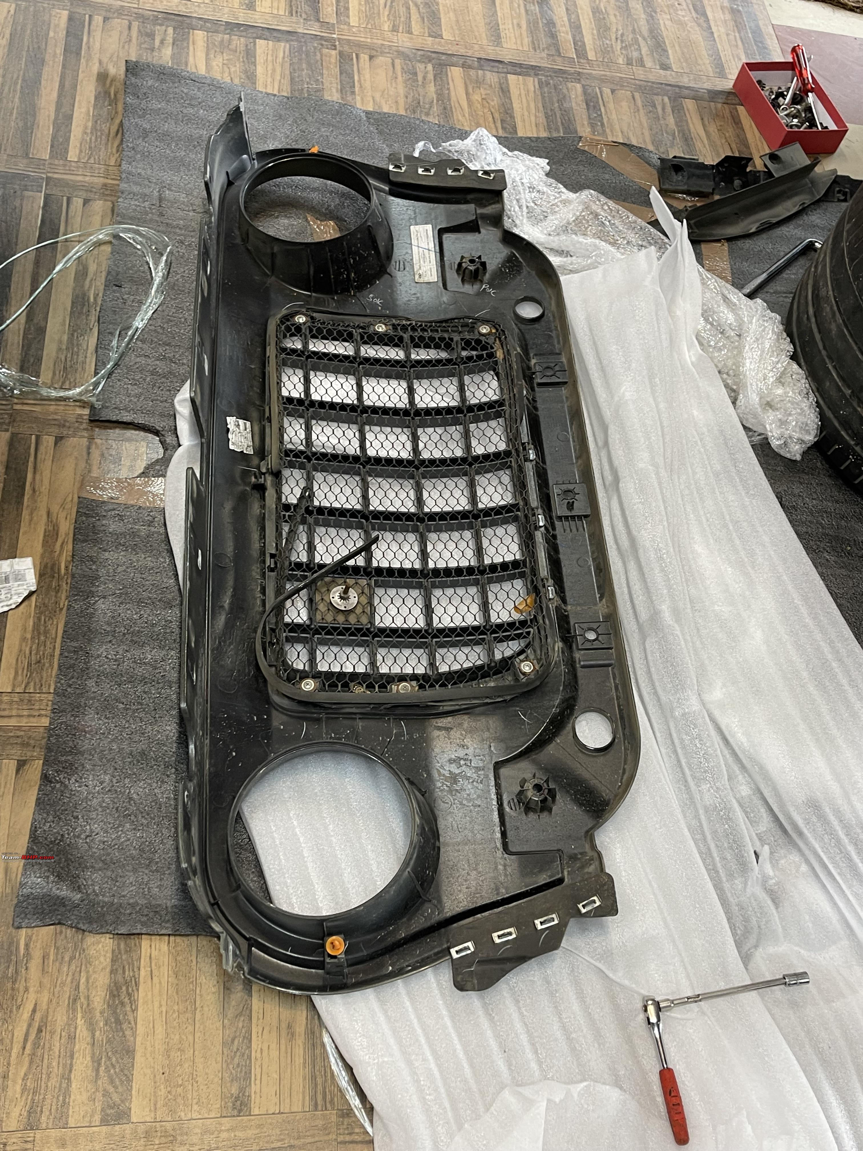

Hi Dhanush - I believe you are right.
Even here in Bangalore’s largely pleasant climate, after a round of short local errands with the AC on, the radiator cooling fan comes on and one can distinctly hear the hum. Indeed, I also believe that the fan comes on more frequently and the hum is more pronounced after I changed my front grille to the more ‘Jeepy’ one.
If you remember the original grille it came with a sort of wide-spaced chicken wire kind of mesh. The new one is a perforated metal grille fascia.
So in my thinking, it just may be possible that the fan comes on more often with this new grille in order to ensure better cooling.
Mahindra Thar : Official Review-img_0246.jpeg
