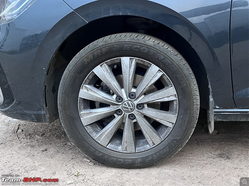

She drives a Virtus that has this strange issue of brake dust getting accumulated on the front wheels. Stubborn stains left behind on the wheels refuse to go away even with a pressure wash. Car is a few months old, 1.0 AT variant, not much driven.
Volkswagen ASS opines that the amount of brake dust is normal and there is no issue with the pads or discs. She took the car to a detailer who was able to bring the wheels back to pristine condition after hours of hard work. But this is the current condition of the wheels, one month and 250 km later.

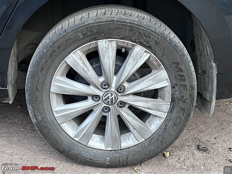

In comparison, the rear ones are very close to their original colour. Ignore the dog pee marks, this car has been sitting for a while.
Besides painting the wheels black, what options do we have to make the brake dust marks appear less obvious? The local detailer has suggested a ceramic coat on the wheels and some Meguiar's cleaning solution to clean them. We are thinking of giving it a try.
Has anyone else faced a similar issue with their Virtus?

Yes this is a normal phenomenon. The front wheels will always have more brake dust due to heavier breaking force required at front wheels.
You can look at wheel cleaners (those with iron particles cleaning capabilities). Spray it on wheels, leave it for 15-20 min and it breaks down the brake dust (colour change as well denoting iron particles removal). You can wash it afterwards with some foam/shampoo and water. This is probably the least rigorous method for cleaning these alloys.
I own a Kushaq and do this once every 3 weeks.
Looks okay to me. The dirt is not from just braking alone. Its accumulation of brake pad dust, general environment dust and grime mixed with oils.
What usually happens when you take the car to the dealer (For service) or any detailer is that they rub the wheel rim and tire side walls with some oily substance. Gives them a nice appearance. They act like dust magnets though. You end up with a wheel rim looking dirty quite fast. More so when driven in rains.
Use normal car wash shampoo to clean the rims and side walls. No other special treatment is required. You need to hand rub the surface with a cloth. Let the soap sit on the surface for a minute and then wash them down. Just use a mug with water and rinse the wheel.
Ceramic coating a wheel rim is unnecessary.
