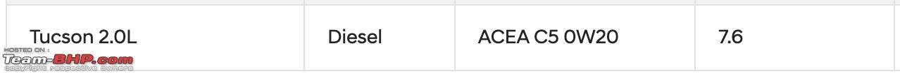

Attention Tucson Diesel owners
The engine oil capacity for the Tucson Diesel was previously mentioned as 7.6L but has now been updated to 5.6L. Also engine oil grade changed from - "ACEA C2 0W30" to "ACEA C5 0W20"
Seeking expert advice: Should the excess 2L of engine oil be drained?
Please check the updated link
Last edited by Mathan1130 : 3rd December 2024 at 12:40. Reason: Added the oil changes info

He has a diesel Tucson, which means it needs 7.6L of engine oil.
Originally Posted by aseem23 View Post
Diesel Tucson engine capacity is 7.6L
It was never 7.6L, at least as per the manual. From day 1 it was 5.6L only.
Regarding the classification/grade, I guess we can continue with the same that we used until now. Hyundai probably is trying to standardise the grade for all the models because of easy availability and optimisation in cost.

This is strange from Hyundai. Since the beginning, Diesel owners have used 7.6L of engine oil. Why this sudden change? They have even reduced the oil capacity. During my last two services, even the service technicians acknowledged that 7.6L of engine oil is for Diesel Tucson. Looking for some transparency from Hyundai on this

I am not sure about the manual but I have checked their website & got the information that Diesel Tucson oil capacity is 7.6L. I am attaching the screenshot for reference which I took two days back & shared with one of my FB friend.
Also not sure what needs to be done further I have driven the car with 7.2L engine oil for more than 23,000 + KMS.

3) 7.6 litres of engine oil was put. All Tucson (diesel) owners are aware of the recent controversy regarding the volume of engine oil - whether it should be 7.6 litres or 5.6 litres. I have written a email to the National Service Head of HMIL seeking clarification on this matter and awaiting his reply.
