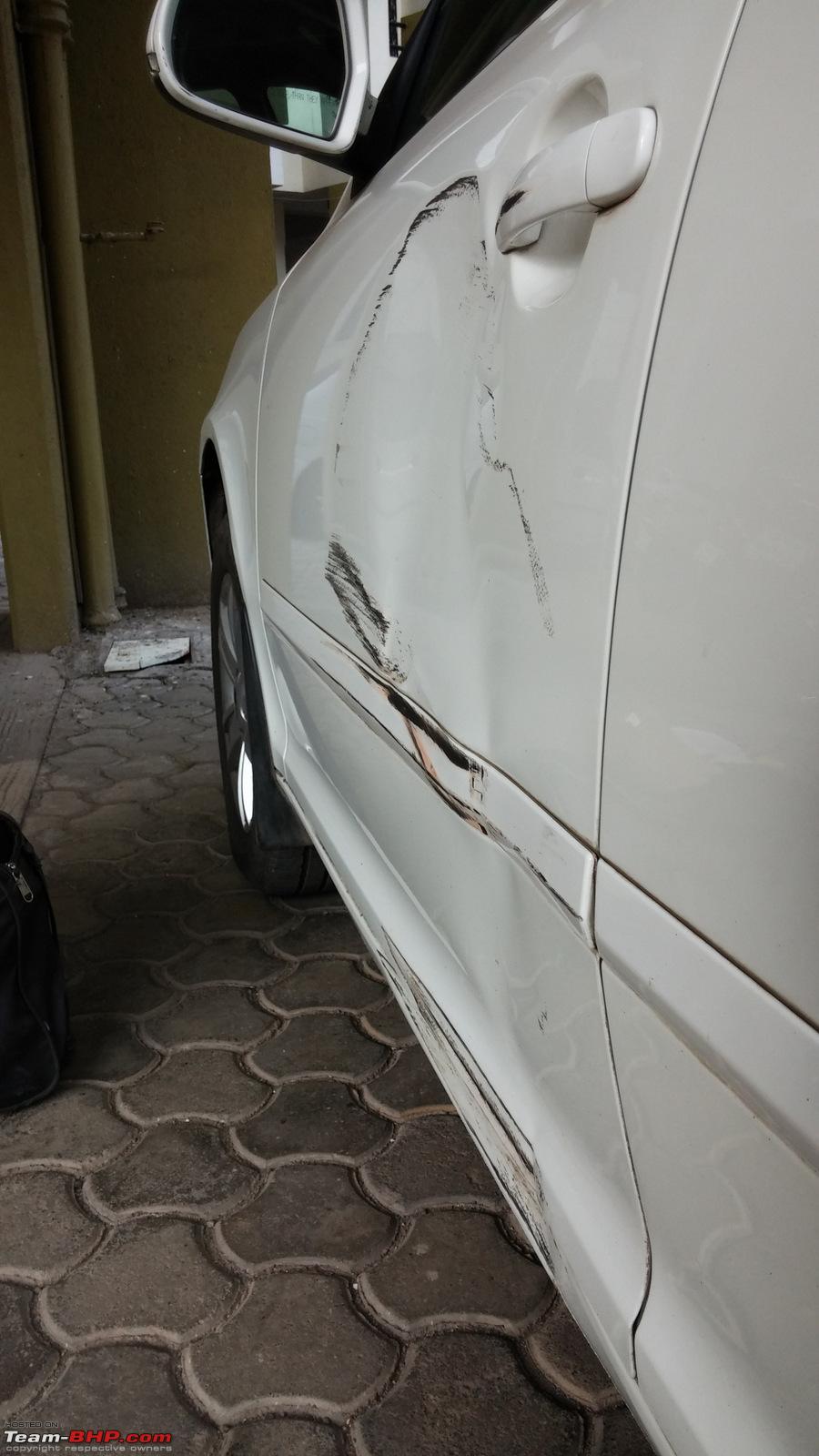

The overall dent:
A closer look at the dent:

He requested me not to take pictures when he actually pulled the dents out as that's his USP, so I agreed.
Overall, he could remove 80% of the dent, the side strip posed a challenge, some areas around it could not be restored fully. Also, as per him, when the door received the hit, the metal hit some parts inside (like the glass winder) and hence a couple of small spots around the side-strip got dented from inside. He used a plastic hammer to even them out, but said that only spot welding will restore them fully. Final result is quite acceptable, original paint is intact, and it's no more an eyesore when you look at the car casually. A closer look surely reveals the uneven surface at places. But I can definitely live with this and take my own time to study this whole dent-painting ecosystem, find a competent and reasonable garage that believes in minimizing wastage, has the right tools and most importantly, calls rivets "rivets" and not "ribbits"

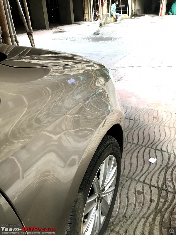

Decided to call Mr. Sudhir Gaikwad (+91 9552629516) today for paint-less dent removal, even though he's based in Pune, I've seen a lot of members use his services here in Mumbai.
As luck would have it, he was very close to my house when I called him today. Called him over, I had 4 dents that were bothering me and needed fixing; didn't want to go to VW for them.
Before:
During:
After:
