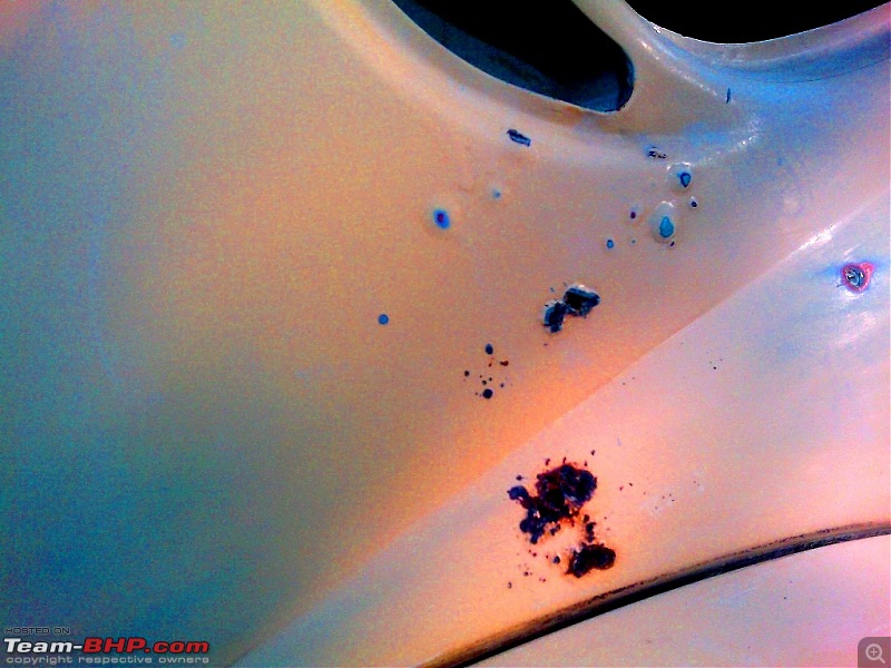

Body work 75% done and the car goes to the Mechanic for the much needed Mechanical overhaul.
Mechanically the car came totally unsound
1) Gearbox making wierd noises
2) Brakes not working and modified with the Maruti Omni
3) Engine tuning off
4) Steering column changed
5) Wheel bearings off
6) Rims Bent
7) Clutch not working / gear shift erratic
8) Suspension work at the front

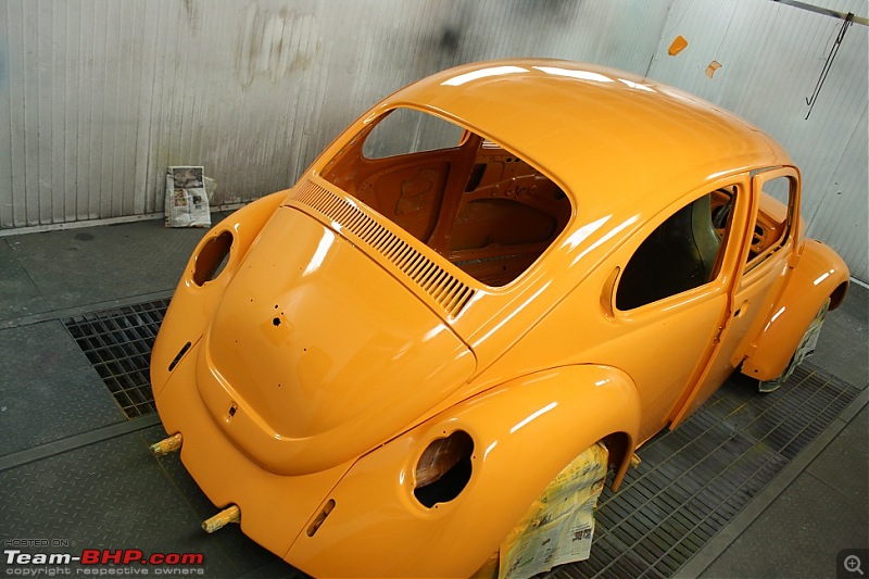

back from the mechanical restoration, the A-Team did a quick job on the bodywork and drove the Bug to the paint booth - GT Tuners.
The shade decided was Orange and since The Original Volkswagen Papaya Yellow was easily available in Dupont, i decided its best to stick to Proved and Tested color rather than experimenting with it. so to match the Orange, we had to spray White as the Base coat in order to accentuate the Orange.
Finally Over the weekend the Beetle was painted and hopefully we might start the fitting and other stuff from midweek.
