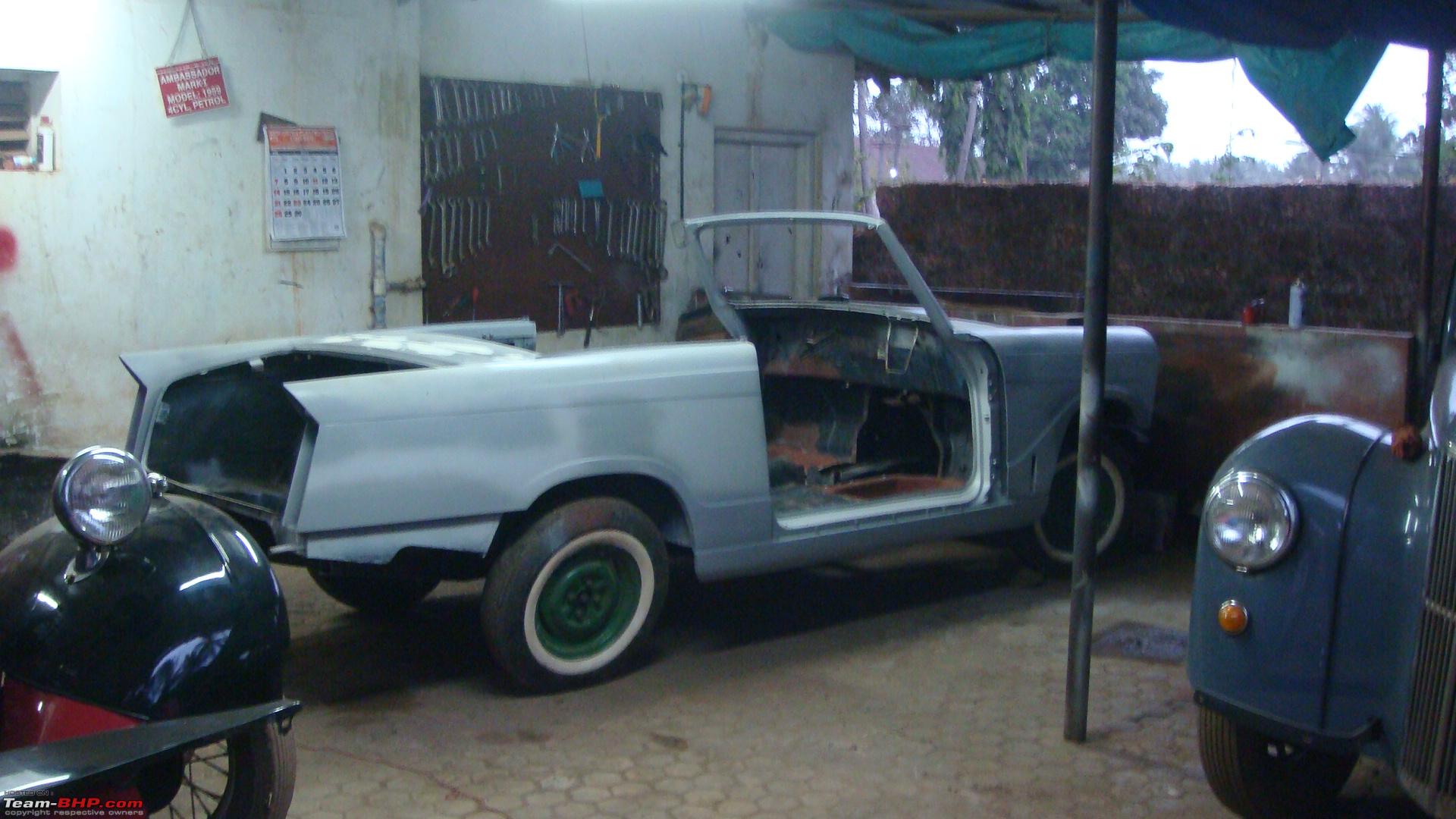

some more pictures on the car

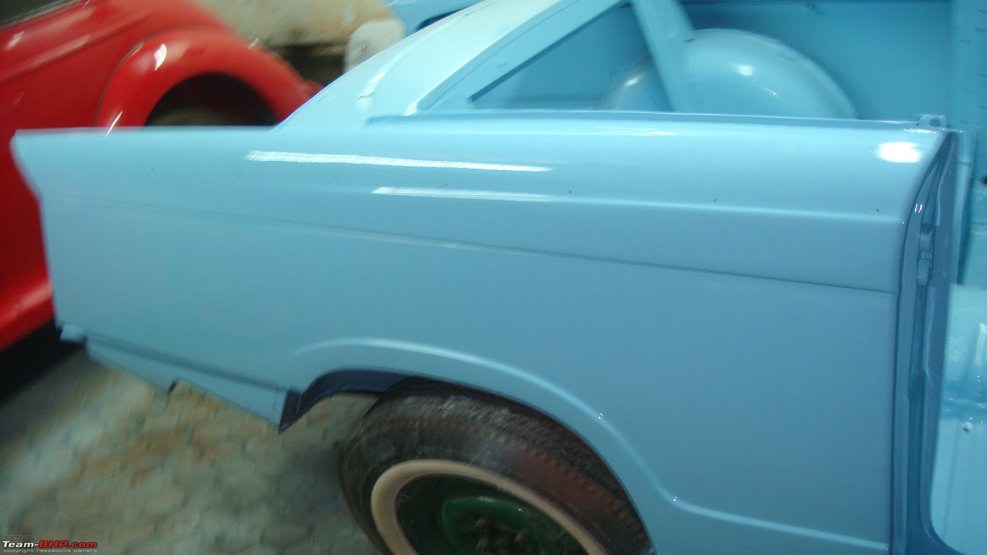

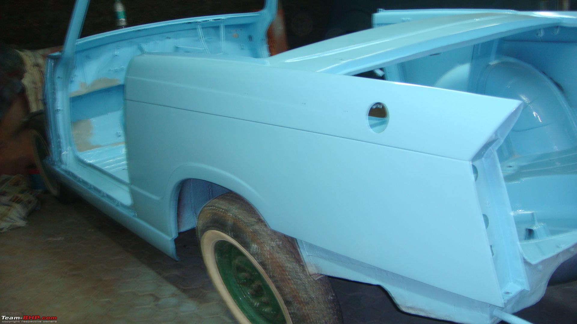

Pardon my ignorance,sir.
Is it just me or is the tyre on the rear slanting.
Or is it something present in the TATRA trucks where once the weight is placed on the truck, the tyres become straight.
Restoration: Triumph / Standard Herald-dsc05678.jpg
roshan_cruise is offline   (1) Thanks
Old 17th June 2013, 14:48   #19
Stanher's Avatar
Location: Hyderabad, AP
Posts: 6,491
Thanked: 2,098 Times
Re: Restoration: Triumph / Standard Herald
Nothing to worry about, that is the normal stance of the Herald's rear wheels, because of the way the rear leaf spring is mounted (as you can see in the pics.) ie. transverse unlike in other cars where the axle has twin leaf springs mounted parallel on either side of the axle. And yes the tyres do become straight once the car exerts weight on the road while running.
Bear with me, just a bit of info I wanted to add. Like the Herald's, Mercedes Pontons and Fintails of the 1950s & 60s also had this sort of appearance on the rear wheels when the car was unladen. The first time my Merc was put up onto a service lift, the rear wheels sagged so much, I thought that they were going to fall off! They when the car was planted firmly on the ground, things straightened out.
However, the Merc stance, though similar to the Herald's, was due to an independant rear axle setup, known as the de Dion axle (named after the company that pioneered it in the late 1800s or early 1900s). The two sides of the axle being almost independent to each other really smoothes out bumps and irregularities on road surfaces.
mbz180 is offline   (4) Thanks

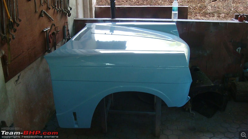

the car happen to have a dashboard made of sheet metal and as it originally came with a wooden dashboard , i got one made with our carpenter.

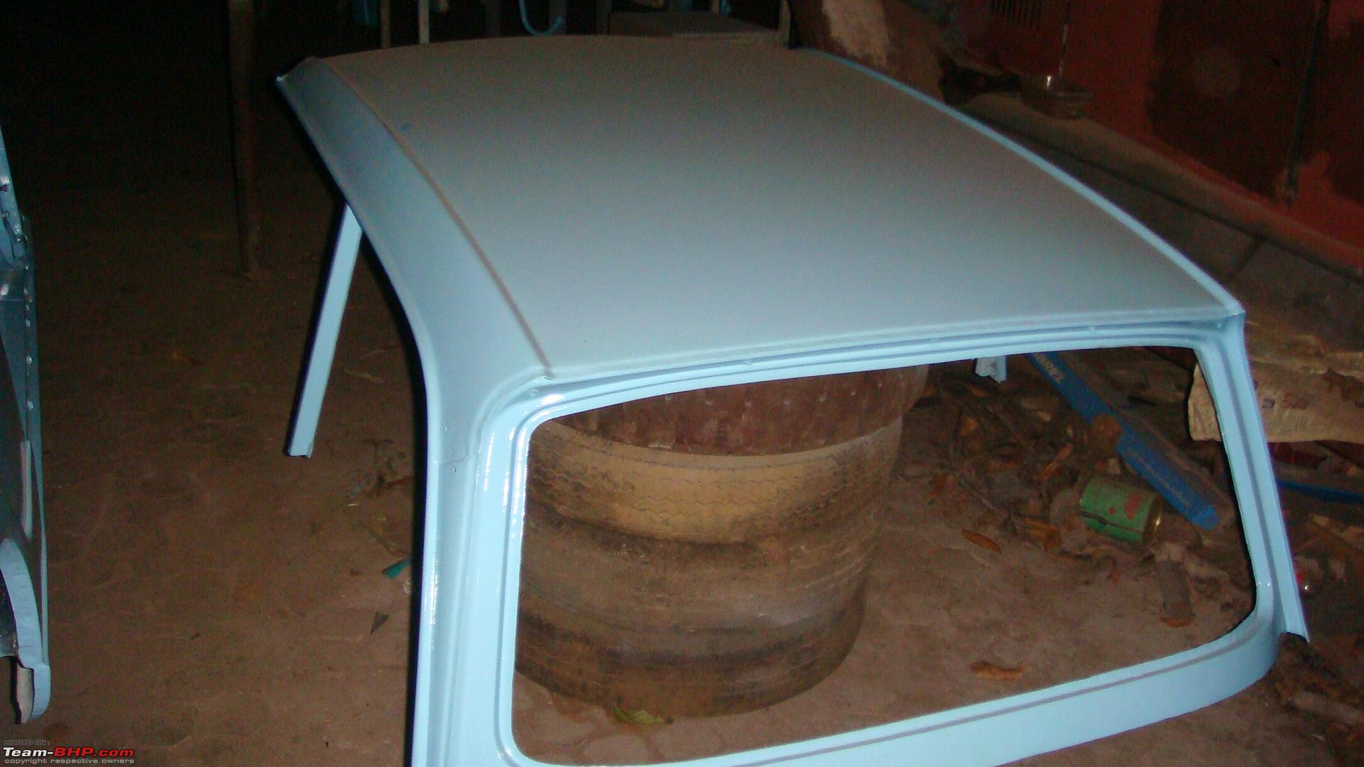

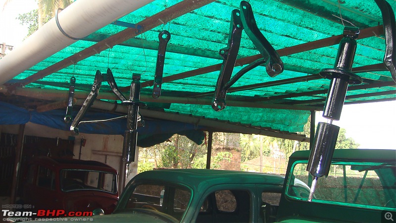

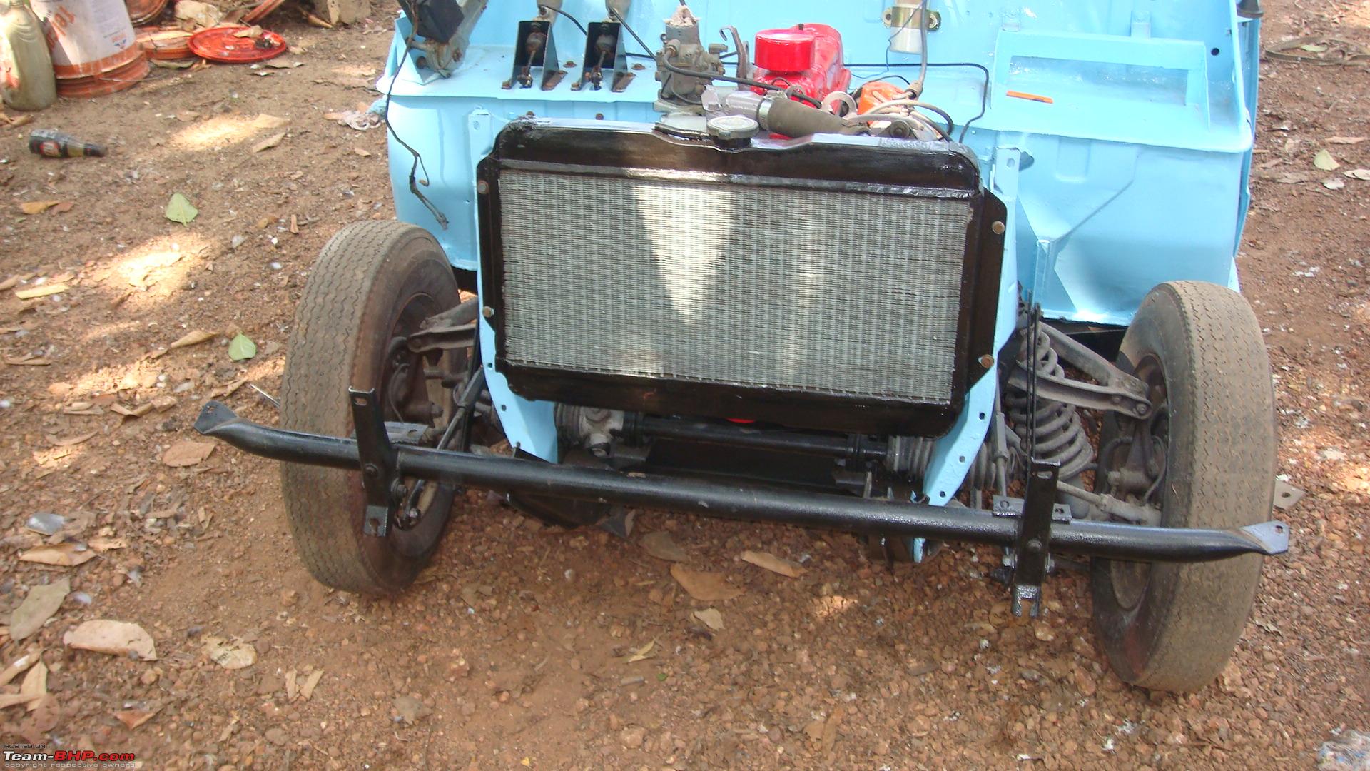

Got the top and the roof liner installed, and also stripped off the mechanicals for paint and to replace all the bushes and worn out bearings and then started off with the wiring. My main concern was sourcing the rubber beadings for the car. Did some trial and error testing with maruti omni beadings, guess what fits right. i had used a rubber for the rear windsheild which happen to be too thick and odd looking so got the one replaced at the later stage.
