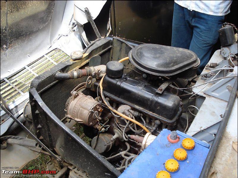

Also the air filter on your car's from an early Herald. This is what the original should've looked like (was on our car til 1987 when it was replaced with a Fiat one, maybe the carb as well) but must be real hen's teeth now!
I wonder if this other design was offered too - I find it unlikely that the unit would have been changed to a much older one, and that too when most everything else on the car hasn't changed.
