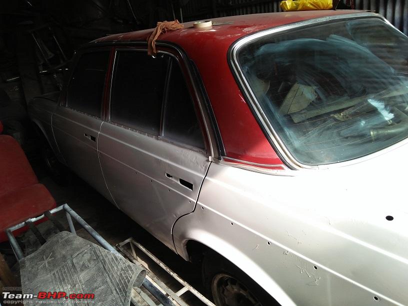

Updates as of 25th August
Scraping off paint and patchwork has resumed.
The spare wheelwell has corroded beyond repair and will need to be replaced in its entirety.

The spare wheel well has been attended to (partially).
Mercedes W123 240D - Yet another addition to the family-img20170829094420.jpg
Mercedes W123 240D - Yet another addition to the family-img20170829094455.jpg
A few body panels were sprayed with epoxy primer to prevent further corrosion damage.

Managed to organise a replacement for Feeroz, the tinkerer (who seems to have put on a disappearing act).
Work has resumed today.
Much of it will involve rectifying the shoddy work carried out earlier..

Updates as of 26th September
The floor panels are being replaced in their entirety with hand-made replacements. Mercedes W123 240D - Yet another addition to the family-img20170926185857.jpg
Mercedes W123 240D - Yet another addition to the family-img20170926185932.jpg
Repairs to the rear wheel wells/running boards..
Mercedes W123 240D - Yet another addition to the family-img20170924182420.jpg
bikertillidie is offline   (2) Thanks
