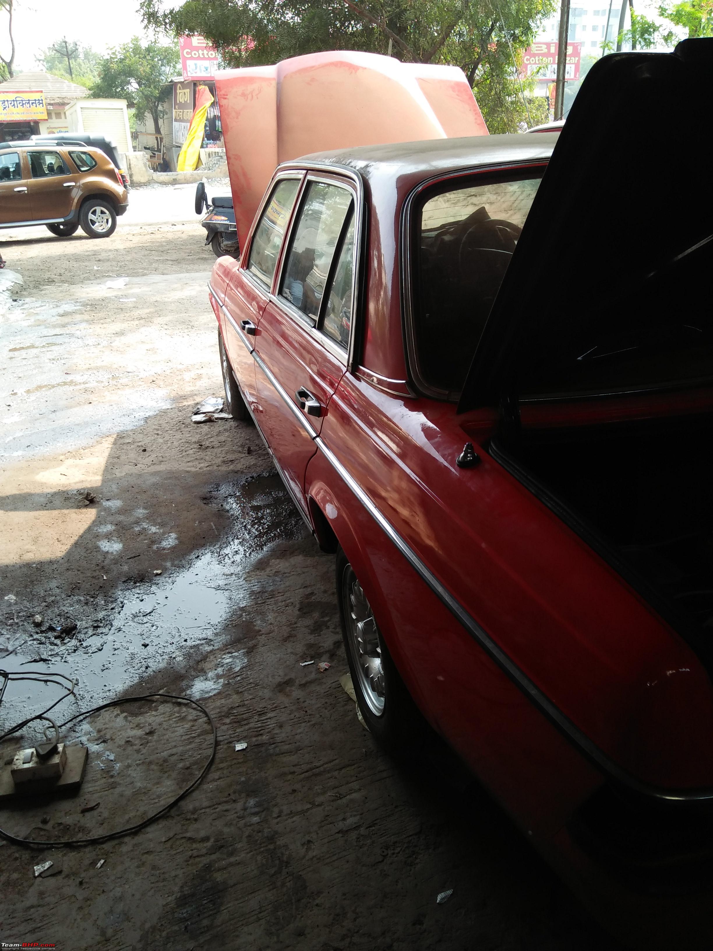

Updates as of 31st Dec, 2017
The car was started up today..
Mercedes W123 240D - Yet another addition to the family-img20171231184133.jpg
Mercedes W123 240D - Yet another addition to the family-img20171231184202.jpg

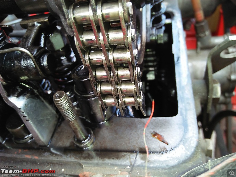

Disaster has struck yet again.
It seems the timing chain has jammed while starting up the engine.
Trying to rotate the engine by hand has proved futile, hence, it looks like we have more work on our plate now.
It's good the engine was not running when this happened ..
That's a pain! Would be interesting to hear what caused it? Timing chain arrangement is very robust and I have come very little problems with it. Are you sure its the timing chain? Maybe something has dropped inside, that does happen to the best of us, unfortanelty.
Good luck!
Jeroen

Re: Mercedes W123 240D - Yet another addition to the family
Thanks.
Will try to inspect the sprockets which form part of the timing gear, check for broken guides & timing chain tensioner over the weekend.
Thanks.
I honestly don't work how the timing arrangement works in diesels but another possibility could be that the timing chain jumped a few teeth and got jammed.
Other reasons of course, like already said, the chain guides, in case any of the holding pins have fallen through, or one of the intermediary pinions has moved out of alignment.
Hope it's resolved without much of an issue!
mbz180 is offline   (1) Thanks
Old 16th January 2018, 13:46   #104
bikertillidie's Avatar
Join Date: Jan 2011
Location: Calcutta/Pune
Posts: 488
Thanked: 1,049 Times
Thanks.
Assuming the chain tensioner works correctly, the chain should not have jumped across sprockets.
I suspect either of the following -
(a) a bolt may have inadvertently fallen into the engine through the oil filler cap
(b) a broken timing chain guide
(c) the oil pump had been removed from the engine and was replaced. Probably, the re-installation wasn't performed by the book, and it's fouling with the intermediate shaft
bikertillidie is offline   (1) Thanks

Updates from 17th January
We finally know the reason.
A snapped timing chain
Mercedes W123 240D - Yet another addition to the family-img20180117165643.jpg
Mercedes W123 240D - Yet another addition to the family-img20180117165632.jpg
