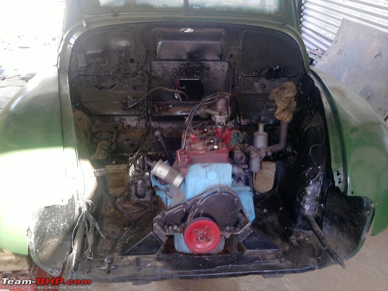

Did the head come in red and the rest blue ? I remember these Morris cars had an all grey engine

Over my recent search results on the WWW, i have always found custom designed engine room.
Hence the scope of following something to the factory spec original has been too limited,
But with my mechanics Dad being a Golden Oldie( He has worked on Dharmasthala Cars of Sir. Virendra Heggade) , i came to believe Morris convertible's engine bay had these combiniations
1) Red - light Blue
2) Black - Grey
3) Red - Racing Green
4) Black - Dark Blue
5) Red - Dark Blue
Missing parts ordered:
1) New radiator
2) Hub caps
3) Airfilter flange
4) Bumper stone guards
5) New hinges
6) Exhaust
7) Fuel filler cap (rear)
8) Original dynamo and 2 blade fan
9) Original fuel pump
10)Suspension and brake parts
11) Cosmetics (all Monograms)
12) Original switches
13) Door Handles
14) Wipers
Going by present stages of restoration i would love if Morris experts could throw some genuine light in leading me to get this Fellow to atleast 90% originality.

Pavan, I don't think the Engine ought to be red. It came in a greenish grey colour. I have a lowlight saloon and a book named 'Original Morris', one of the famous 'Original' series of books, which gives the correct combinations. I'll locate it and send you tips on originality.

I was going through the book 'Original Morris Minor', by Ray Newell, published by Bay View Books. This book gives photos and originality tips regarding Morris Minors from the early low lights to the Morris 1000 and their variants. This is what it has to say on the engine colour of series MM cars:
"The cast iron block and cylinder head along with the alloy sump were painted grey on the majority of cars. Howver, some cars were originally supplied with engines painted in light blue, others were finished in red and towards the end of production, green was introduced. Lack of adhesion of the paint applied to the alloy sump has resulted in some restorers leaving the sump unpainted. Evidence from early photographs and workshop manuals suports the view that this item was originally painted."
