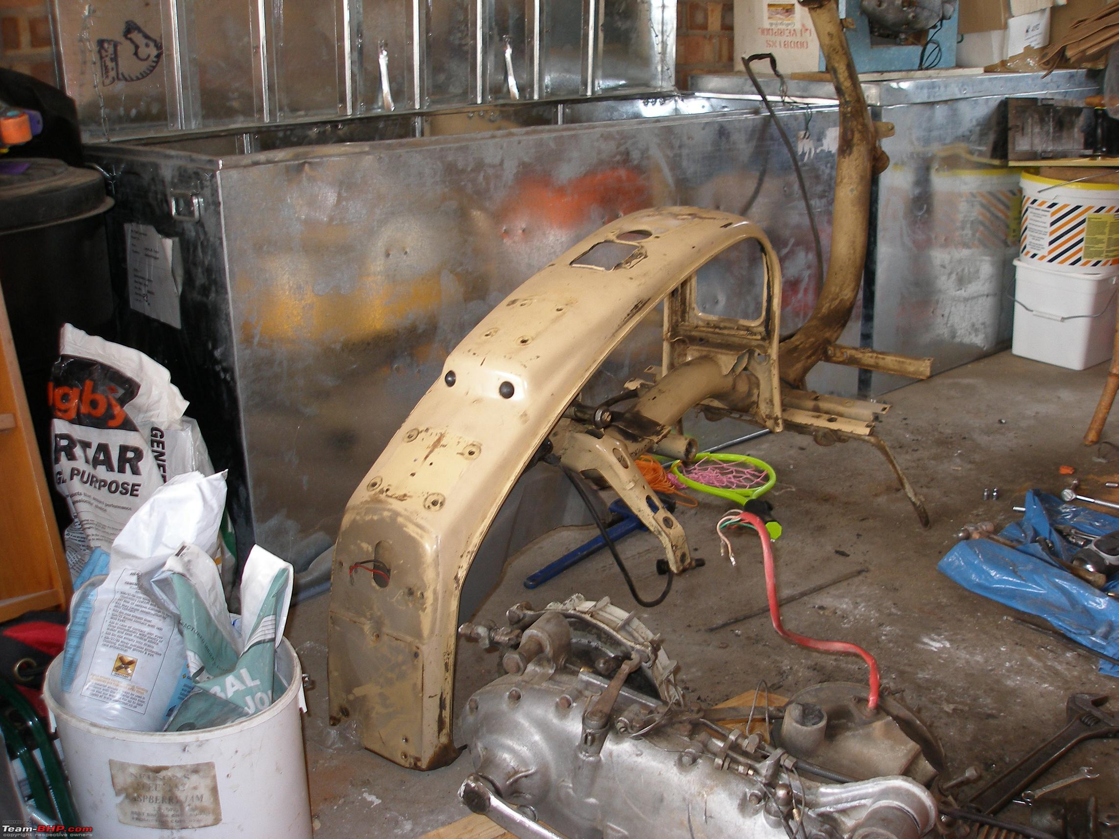

I bought a 1980 SIL Vijay Super Mk I in 2004 from an importer in Leeds, England. This scooter has spent its life in Northern India and was received, dismantled, for shipping in a metal box.

After a very hard life carrying, who knows, maybe up to five people at a time, now is the time for a makeover and a hard earned rest.
First its a total strip down, then off to the beadblaster, only a very light blasting mind, to remove all remnants of paint and rust.
At the same time, total strip down of engine and rebuild using decent quality parts - or so I thought until I broke the engine mount.
Major rethink required.

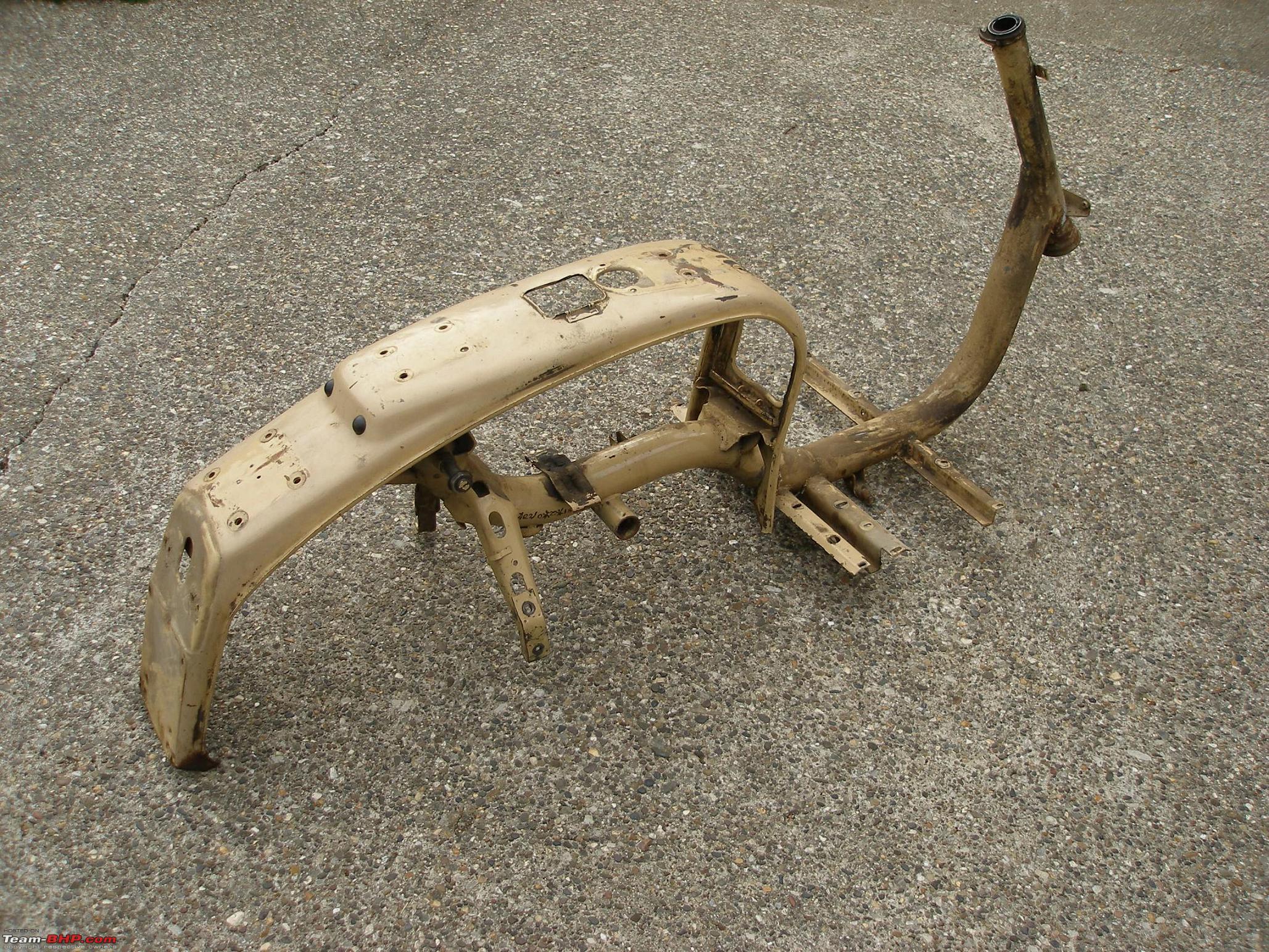

Here's a few more pics of the Vijay in its raw state.
