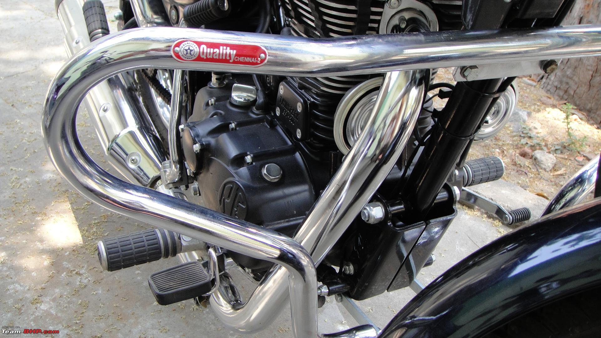

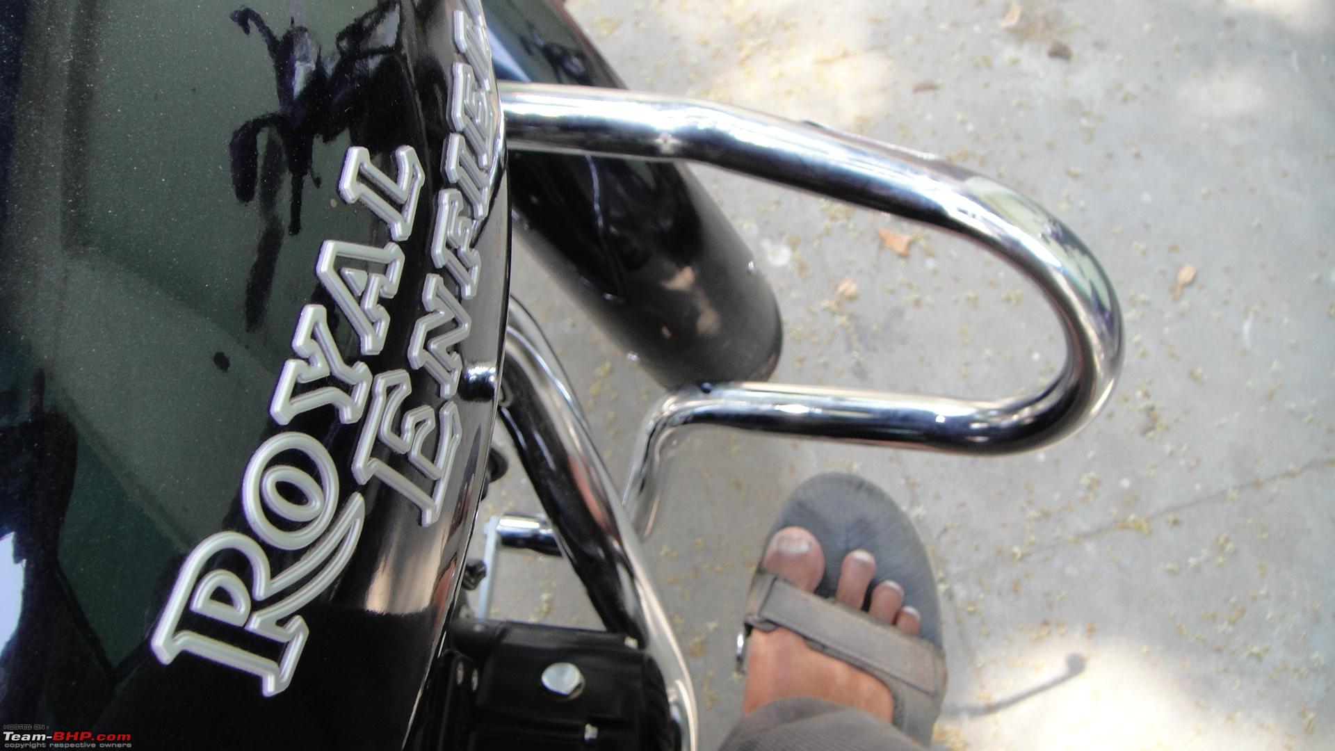

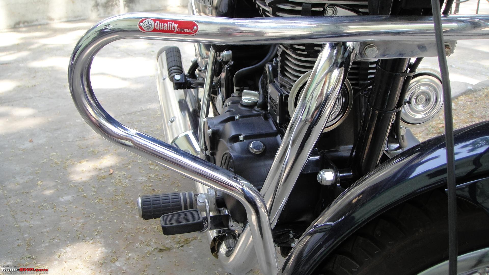

Today, my new Royal Enfield Thunderbird 500 got a new crash-guard, exclusively designed for new Thunderbirds from Quality Metal Industries, Ellis Road, Chennai, costing Name:  rupeesymbol.gif
Size:  578 Bytes850. It's chrome-plated. Similar black powder-coated one costs Name:  rupeesymbol.gif
Size:  578 Bytes 750. But, I preferred the former. This crash-guard is good and a perfect-fit for my Thunderbird. It does not obstruct my foot-wear. Here are some photographs.

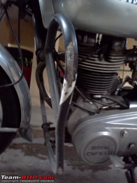

I'd like to share an experience on how the crashguard on my bike saved damage to my bike and me few days ago.
I have been using the old army design crashguard on my Bullets for quite sometime now. Not only does it suit the bike for me, it is a thick gauge crashguard which means it can take a lot of crashes and basially does not break off like my previous crashguard which I bought from the showroom did.
The crashguard has taken a fall already on the right side once and was bent back into shape at the lathe. On my older crashguard which was just a hollow rod bent into a butterfly design, after one fall, the rod bends at the chassis clamp and when pulled back, it cuts the metal which is then welded which makes the crashguard pointless after that. Basically a use and throw crashguard. And this crashguard used to bend even when nudged against anything.
I had bad fall few days ago after a dog hit. I went scrapping across the road and the bike slid a few feet away from me. Like someone had mentioned on this thread, the footrest on a Bullet takes a lot of impact when the bike falls and slides. Luckily, on a Bullet, it does not break off, it bends since the rubber is on a thick iron rod which can be bent back into shape.
The second point was the handlebar and my clutch lever broke off in this case.
The crashguard protected the tank and possibly a fork bend from happening since the handlebar would have taken a huge impact without the crashguard.
The crashguard this time did not even go out of shape, just had deep scratches on it at two points. Pictures attached.
