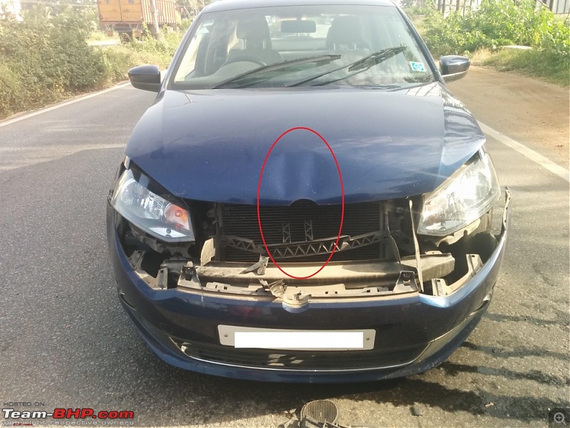

Hi joey645, my guess, without actually looking closer at your car, is that you had a slow-speed shunt. As many have said before on this thread, your speed of impact was quite low. In addition, you may have certain misconceptions about how airbags activate, when you say...
Originally Posted by joey645 View Post
...maybe the impact was not enough for the inertia to reach the steering wheel?
A quick look at your car, with the zone of impact marked, shows that you hit a pair of vertical steel bars or something similar, which left the two dents on the bonnet as well as crumpled it a bit. This can hardly qualify as a full frontal impact at 50-60 kmph. Your headlights are not broken/majorly displaced, the actual steel bumper below the plastic bumper cover is visible and not bent, and the radiator was pushed back because it is fixed to the steel member on which the bonnet catch is located. The plastic bumper cover was probably ripped forward and dislocated when the two vehicles were separated from each other after the crash.
My opinion: you're probably over-reacting about the non-deployment of airbags. Your speed at impact would probably have been more like 5-10 kmph. An accident investigator would be able to assess the speed more accurately on physical inspection of the car. Approaching a consumer court is your choice though, but VW might just keep back your car till the case is settled, whichever way the decision goes.
As to the 2-lakh-rupee bill, well, if everything that's even got a little ding or scratch on it is being replaced, that's invariable. VW spares are never cheap anyway, and they know you're covered by insurance for most of the cost.

Looks like your impact speed was well below 40 kmph. From 80kmph when you spotted the tempo, you mentioned you braked and then collided with it. In that 3-4 seconds your speed may have washed off from 80kmph to may be 30kmph or so, in between you may have seen the speedo (when it was decelerating past 60), or your brain may not be able to comprehend the rapid speed loss, and hence you felt you crashed at 60kmph.
Either case, its good the you are fine and the car has also got a relatively minor impact. As mentioned by others, airbags will not deploy when the speed is slow, or the impact felt is less

The crash member behind the plastic bumper is intact. The ABS sensors are behind that. The ABS did not deploy.

Hey joey645 I am really sorry to learn about the mishap and like everybody else on this forum, very glad to understand the damages that resulted are completely replaceable/recoverable.
As soon as I read your post, I looked through Wiki to better understand how these airbags are actually designed, what triggers them and so on.
My intention is not to take your time or argue with the incident, but just to share some useful knowledge base:
Link
Excerpt from the article which may possibly explain your situation:
Unlike crash tests into barriers, real-world crashes typically occur at angles other than directly into the front of the vehicle, and the crash forces usually are not evenly distributed across the front of the vehicle. Consequently, the relative speed between a striking and struck vehicle required to deploy the airbag in a real-world crash can be much higher than an equivalent barrier crash. Because airbag sensors measure deceleration, vehicle speed is not a good indicator of whether an airbag should have deployed. Airbags can deploy due to the vehicle's undercarriage striking a low object protruding above the roadway due to the resulting deceleration.
