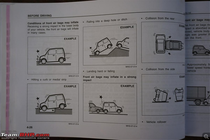

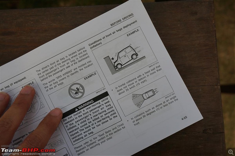

Some relevant pages on when the airbags Do & Don't deploy - from the Maruti Celerio owner's manual:

The little car seeing "stars" on impact in the Celerio handbook is quite funny!
