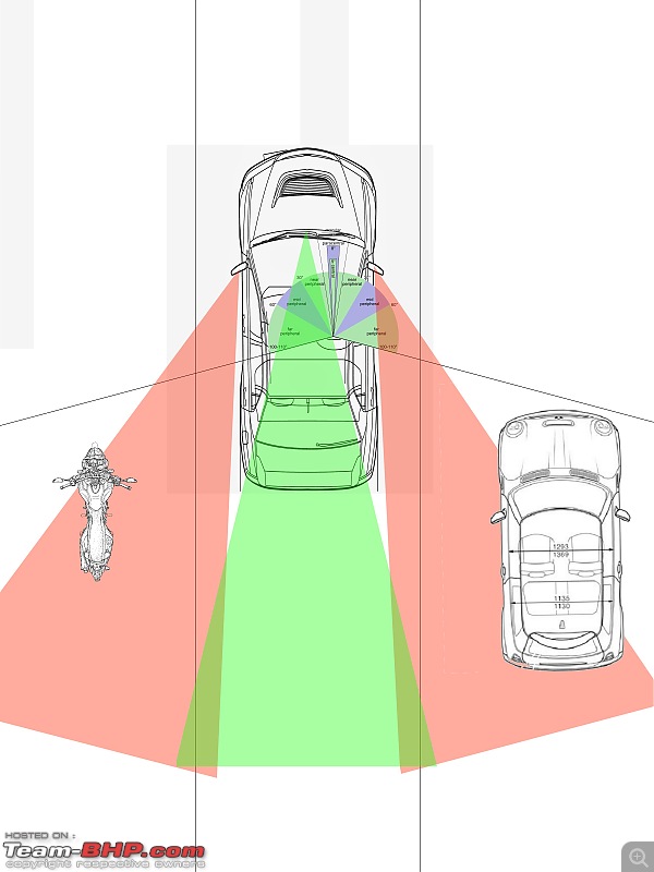

Eliminating Blind Spots - How to correctly adjust the mirrors-orvm-incorrect.jpg
What is wrong with the above setup? Pretty much everything. The motorcycle and the smaller car on either side are totally invisible to the driver. Part of the view covered by the IRVM is repeated by the ORVM, which is redundant and useless.
While we are driving down the road, the side of our car isn’t going to magically disappear. Despite supposedly developing object permanence at age 2, most of us are constantly terrified that the sides of our cars are going to disappear if not constantly monitored. To help assuage this fear, we set our side-view mirrors to help us watch and make sure our cars haven’t magically opened up into sideless wonders at some point.
Then again, maybe it is the name of the mirrors that confuses people. After all, they are called side-view mirrors. Perhaps drivers hear the name and believe they are intended to help them view the sides of their cars. Nobody believes that rear-view mirrors are intended for viewing the rear of their car — that would be silly and useless — but then again, using your side-view mirrors to view the sides of your car is equally ridiculous.
Side-view mirrors are on the side of your car, yes, but they are actually intended for viewing what is beside your vehicle, not the sides of your vehicle itself.
If you set up your mirrors properly, a passing car will appear in your rear-view mirror, transition into your side-view mirror, and then transition into your peripheral vision. It will do so seamlessly, and it will do so without ever fully disappearing from one of your mirrors until it is clearly visible in your peripheral vision. Those blind spots you are constantly worried about just disappear. The human peripheral vision extends upto 200 - 210 degrees. See illustration below.

How exactly does one go about obtaining this miraculous arrangement? It is simple, really.
First, you sit in the driver’s seat and lean your head against the driver’s side window. Adjust that mirror until you can just barely see the edge of your car, then sit back up. Lean approximately the same distance toward the passenger side, and do the same thing to the passenger side mirror. Once you sit back up straight, you’re done. You should not be able to see any part of your car in the ORVMs without tilting your head to one side. This is what you should ideally see in your rear view mirrors
Eliminating Blind Spots - How to correctly adjust the mirrors-orvm-correct.jpg
The exact positioning of each mirror may require some fine-tuning, but once you get it right, you won’t ever have to worry about changing lanes and accidentally hitting a car you couldn’t see. A car in your rear-view mirror will be partly in your side-view mirror as it begins to pass you, and even when you can see a car beside you out of the corner of your eye, it will also still be partly in your side-view mirror. Brilliant, right?
