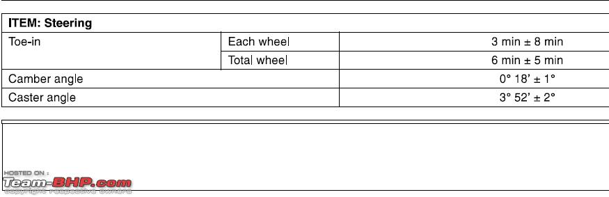

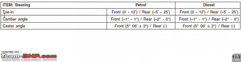

Re: Why the heck will Maruti-Suzuki not fix its defective & dangerous steering behaviour?
Originally Posted by shancz View Post
Either way will see if I can find something concrete else its just guessing
Was in a workshop for some brake issues and managed to catch a Ritz being worked upon, see the pic in comparison with with my car :
Why the heck will Maruti-Suzuki not fix its defective & dangerous steering behaviour?-ct_comparo.png
And here are the details from their respective owner's manual : Credits to Providers MSIL : Car Care
Ritz:
Why the heck will Maruti-Suzuki not fix its defective & dangerous steering behaviour?-ct_ritz.png
WagonR :
Why the heck will Maruti-Suzuki not fix its defective & dangerous steering behaviour?-ct_wrst_ft.png
SX4 :
Some points :
  • The Ritz caster angle looked about double that of WagonR which is also confirmed by the data.
  • This would mean that the returnability of Ritz should be better than that of WagonR. I have never driven a Ritz, hope any BHPian could confirm this.
  • Went through all the manuals available at the MSIL website, seems like they have stopped mentioning this info in the later models.
  • The SX4 has almost similar caster angle as the WagonR, If that doesn't have this issue then the caster angle is not the only variable here. But if it does have it then caster is the most probable cause. And then it would mean that it is by design.
From a layman's perspective seems like the caster angle is the cause for this behaviour. But this data is very small and if SX4 doesn't have this issue or Ritz has this issue then this argument doesn't hold.
I think I am more confused now than I was earlier
