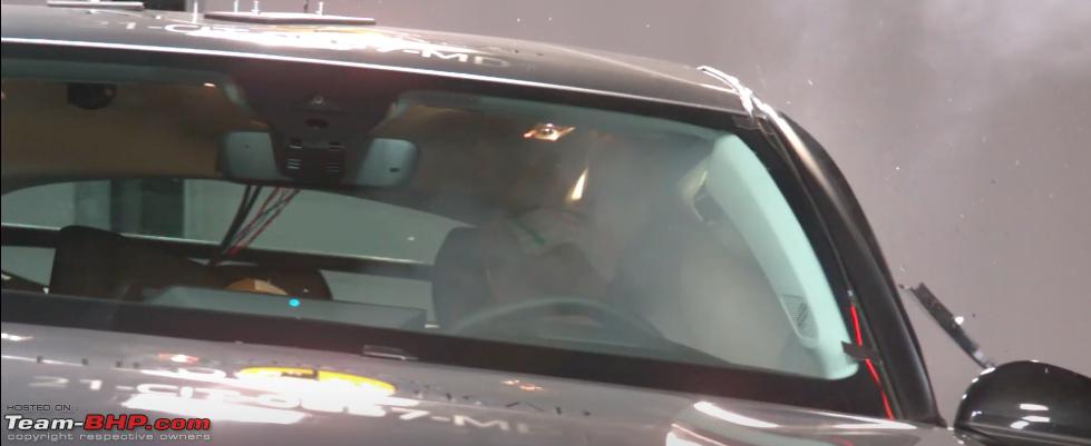

Originally Posted by ron178 View Post
  • Global NCAP hasn't released videos of the 2014 UNECE Regulation 94 56km/h frontal impact tests on the Alto 800, i10, Figo and Polo (they have released some scattered images for the Nano). The Figo was the only one that passed, when the driver dummy "narrowly avoided contacting the steering wheel". Also, in the test report for the Nano, the still used is from the R94 test, not the 64km/h test (which can be seen in the words 'UN R94' pasted below the test code instead of 'NCAP'. They also haven't released videos for the driver-side side impact test on the Mahindra XUV300 which they claim to have conducted (and the last digit of the test code confirms it).
Here's some interesting trivia about the 2014 Indian-market Suzuki Swift with double airbags tested by Latin NCAP (please use YouTube's Portuguese-to-English translator for the subtitles):
At 4:47 you can see the dashboard nearly separating from the door pillar which could explain the integrity of passenger compartment modifier (unstable structure).
At 5:38, you can see a before-and-after view of the rearward and upward displacement of the clutch and brake pedals, and it looks quite concerning.
Name:  Screenshot 20211203 at 7.58.53 AM.png

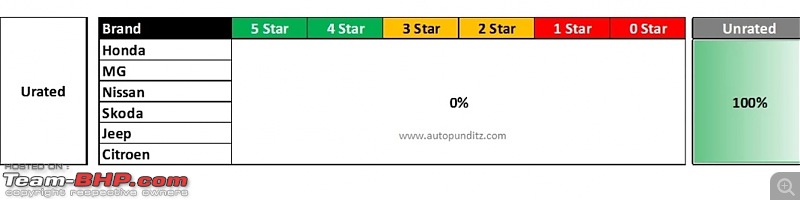

GNCAP - Unrated manufacturers
Global NCAP crash tests | Broken down & explained-smartselect_20220117093730_chrome.jpg
