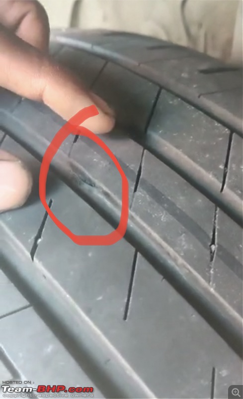

I could also hear hissing sound when I was checking the pressure of the front left tyre indicating air gushing out of tyre rapidly through some hole.

Around 1 inch cut in front right tyre through which air was escaping.

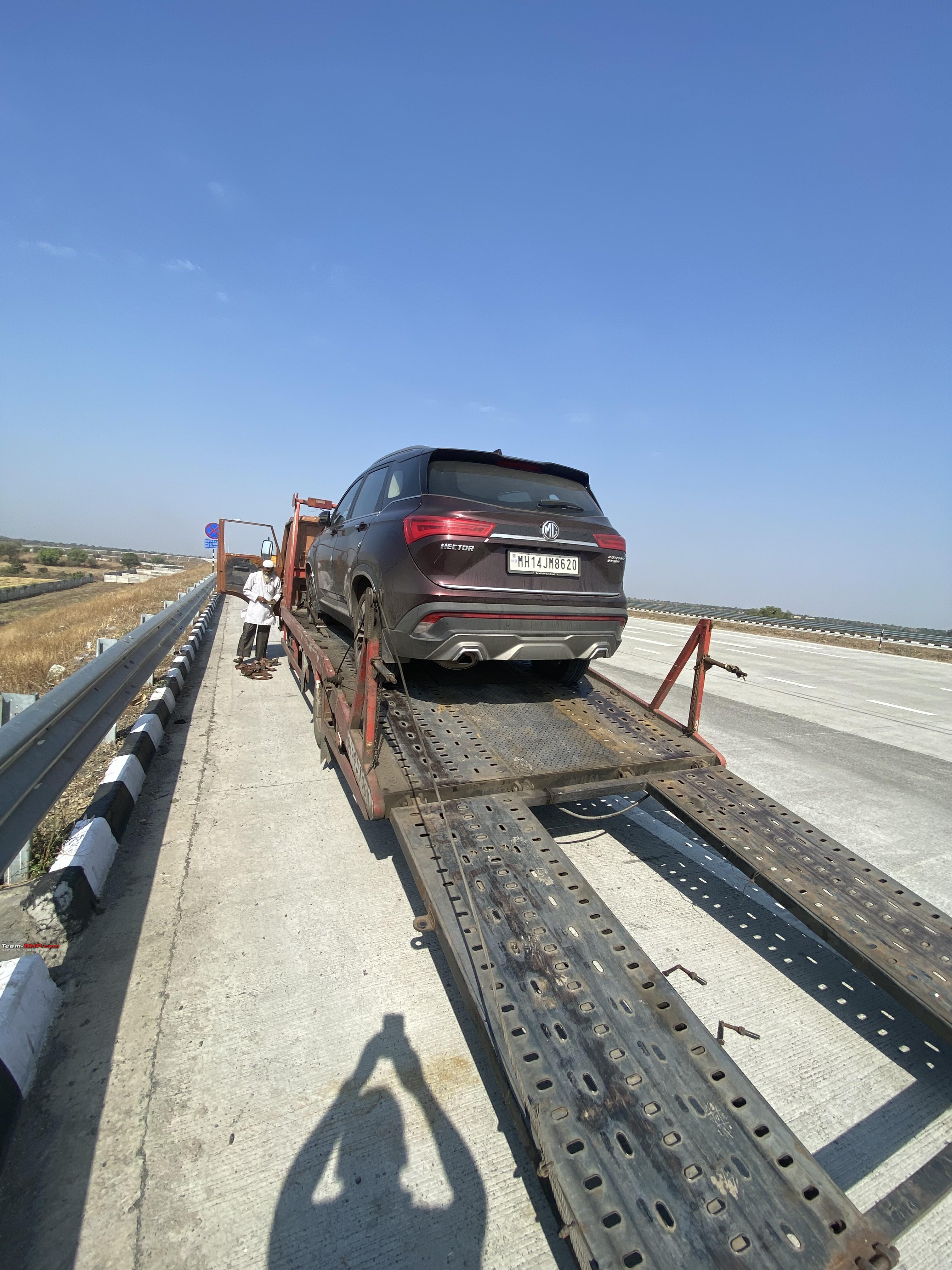

Hector loaded on flatbed.
