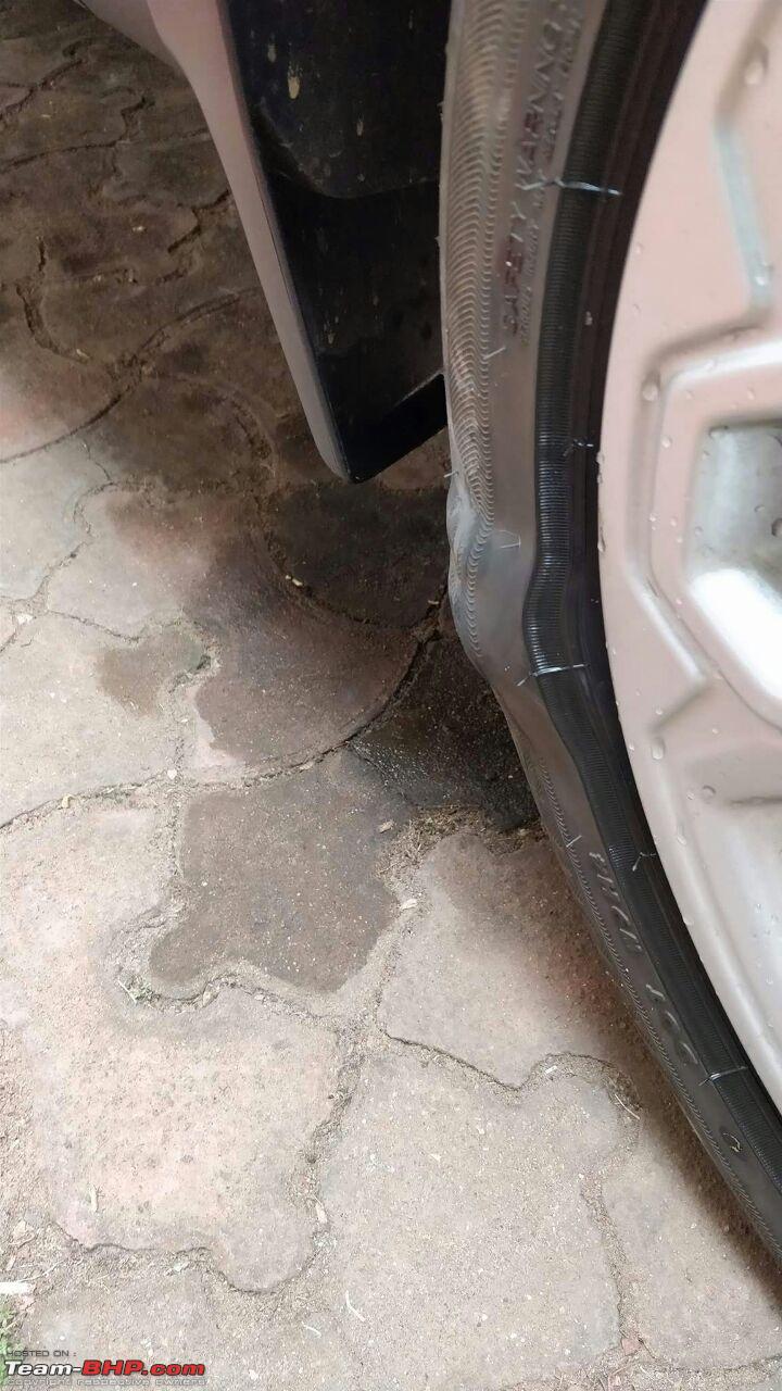

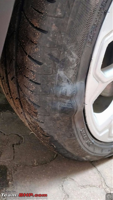

Got these pictures over whatsapp, I guess we already have a case of tyre failure on the 17 inch rims here in this thread too. I don;t understand why Ford went for 17 inchers for Indian road conditions or they are waiting for something like the Firestone fiasco before sitting up and acting on this issue:
The alloys in that pic have hit something as can be seen from the deep scratches on the rim. Not much can be done in that case.
Aha, thanks for your observation Viddy, things are a bit clear now.
But I have taken a hit on my VW Polo highline rim too and although there came a bubble, but nothing was close to the one seen here, please do enlighten.
Yes, read about this in the Facebook EcoSquads group where the owner had posted these. He had already driven 4k kms and this happened. Around 10 owners in that group have faced issues with the 17" tyres. Seems like an issue with the Bridgestone Ecopia.
After reading about this discussion on this thread, the owner has reported in Facebook that he had washed the wheels and the water droplets are making it look like scratches from some angles. He has posted another close-up pic as well to clarify.
He has also reported that he went to the dealership and it seems like this issue has finally got Ford's attention. The dealership has received mail from Ford about this and they'll be replacing the tyres after verifying with Ford. Awaiting further updates.
