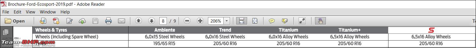

Ford India has stopped 205/50R17 profile tyre in entire fleet of EcoSport. Earlier they stopped from Titanium+, later from Signature and now from Thunder edition too. Its a welcome move as low profile Bridgestone Ecopia never survived on Indian roads and complaints of tyre cut, bulge, burst were always there. Finally Ford listened to their customers. Tyre profile snapshots from latest EcoSport brochure.
Variants other than Thunder.
Ford EcoSport Facelift: Tyre bulging issue (R17 size)-1.jpg
