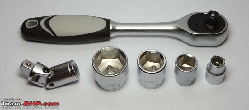

Originally Posted by vnabhi View Post
Thanks, but does it have an adjustable opening, like in an adjustable wrench?
Further, the wheel wrench given with most cars will be hard and long enough to stand on when the nuts are tight, right? In that case, why is this necessary?
That is a socket wrench.
Socket wrench - Wikipedia, the free encyclopedia
I don't think it works well for tire nuts. I have broken 2 such wrenches in the past. The spring mechanism just went kaput.
So you need to buy something of very high quality. Both the wrenches I wrecked were made in China but purchased in Dubai.
The difference between a normal wrench/spanner and the ratchet handle/wrench is the 'ratchet'. The ratchet mechanism within this wrench allows you to lock it in either clockwise or anticlockwise direction. When you lock it for clockwise movement, such as tightening a nut, you turn the wrench clockwise to turn the nut. The ratchet allows you to turn the wrench anti-clockwise without turning the nut. This allows you to turn the nut in small and fast increments. With an ordinary wrench you would have to turn the wrench a whole 360 degrees.
To give an example, imagine you have to tighten the nut on your car's wheel. With an ordinary wrench you put it onto the nut and turn the wrench clockwise. Assuming you are exerting downward pressure, you have to position the wrench parellel to the ground, on the right hand side of the nut. Then you press it downward about 30-40 degrees. You may not be able to turn it 90 degrees or else your hands/palms will graze against the ground. Once you turned it, you have to remove it from the nut and reapply it onto the nut in the original (parellel to the ground) position.
With a ratchet handle, you lock it for clockwise direction before applying it onto the nut. The initial position is parellel to the ground, just like the normal wrench, and you apply identical downard pressure to turn it approx 30-40 degrees as allowable. Now, instead of removing the wrench and repositioning it, you simply turn the handle anti-clockwise, turning it back to the parellel position WITHOUT REMOVING THE WRENCH. Then you repeat the downward pressure/clockwise turning movement. This way you can turn the nut faster.
If you are not aware of how ratchets work, it would be best if you can watch a mechanic use it to understand how it works different to the normal wrench.
