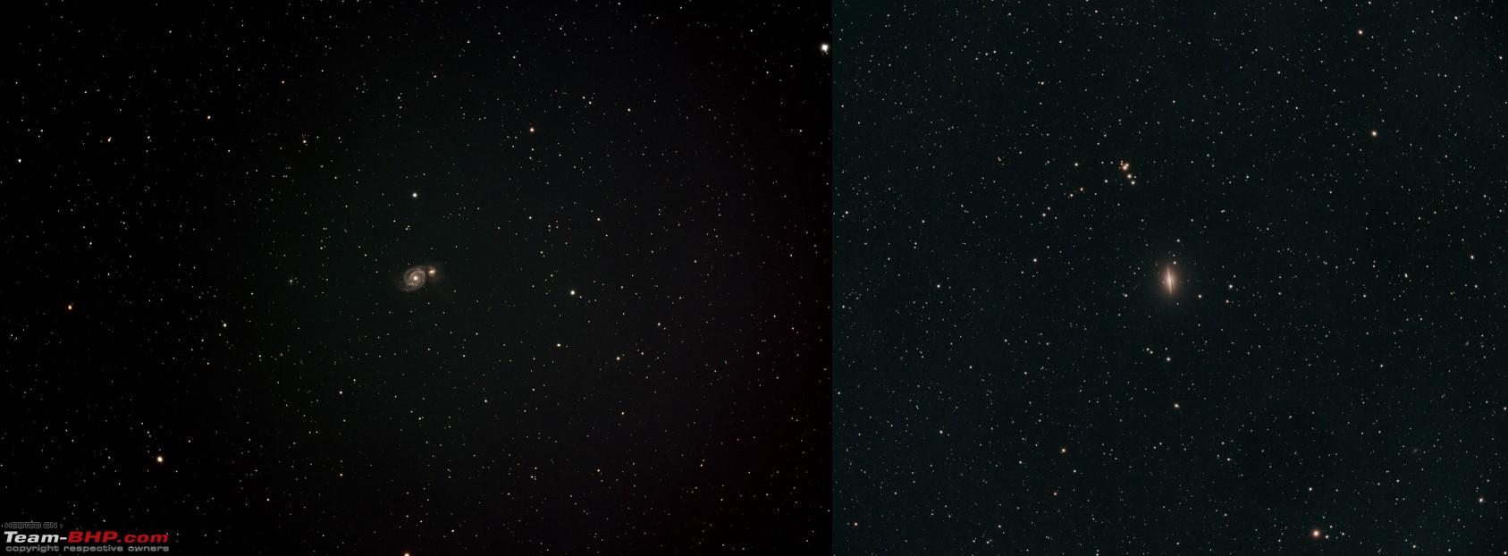

Setting up the Celestron 6SE
The refractor telescope setup with the William Optics GT81 with the effective focal length of 384mm is good for shooting large objects like large nebulae, large galaxies etc. But it falls short when it comes to shooting smaller objects. Most of the galaxies are too small for this setup. For example, below is the uncropped images of the Whirlpool galaxy and Sombrero galaxy that I shot with this setup.
See how small the targets are in the frame. The images have to be heavily cropped to be able to see the objects in detail. This also means lack of resolution on the target and it is difficult to bring out the minute details in the target.
The solution is to shoot these objects with a longer focal length. The other scope I have is a Celestron 6SE Schmidt-Cassegrain telescope. This scope has a focal length of 1500mm. When I add a 0.63x field flattener / focal reducer, the focal length reduces to 945mm. But this is still more than twice the foal length of the refractor. So I decided to set up the Celestron 6SE for photography. Below were the problems I had to solve for this.

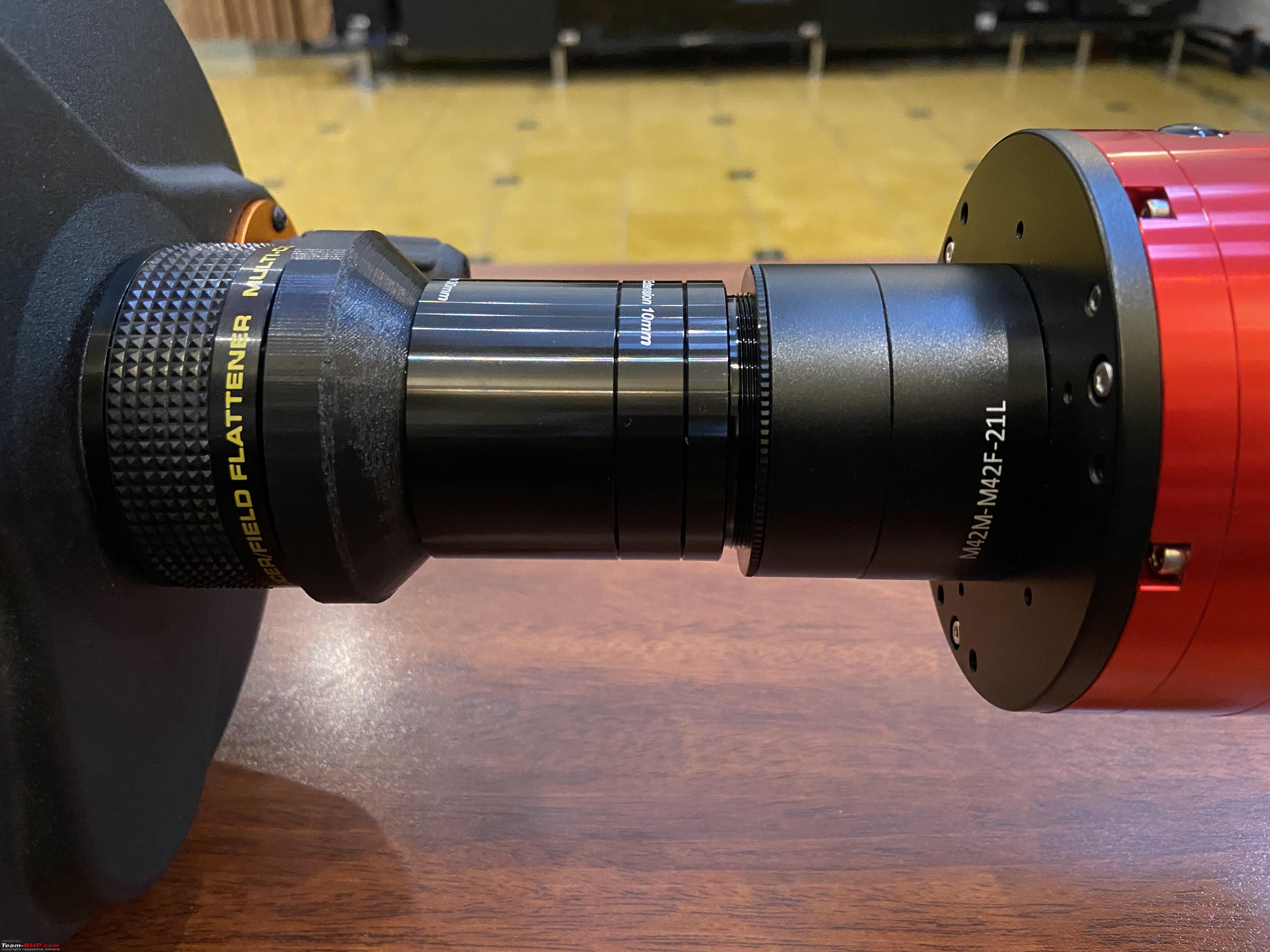

For #2, Celestron makes an adapter that has matching thread that fixes to the telescope on one side and thread matching the camera and spacers on the other side. However, this item on Amazon had a lead time of 3 to 4 weeks. As I had only a week at the most before monsoon sets in, and I wanted to capture some targets before monsoon, I decided to make this adapter myself. The adapter has a 2" 24TPI (24 threads per inch, 1.05mm pitch) on one side and 42x0.75mm (42mm diameter, 0.75mm pitch) on the other side. Made this model using FreeCAD an open source CAD modeling software and 3D printed it, and assembled the system.
The 3D model design.
3D printing.
Rendezvous with The Universe | My Astrophotography Hobby-3d-print-progress.jpg
Rendezvous with The Universe | My Astrophotography Hobby-3d-print-complete.jpg
Camera fixed to the telescope.
Rendezvous with The Universe | My Astrophotography Hobby-complete-setup-1.jpg
Rendezvous with The Universe | My Astrophotography Hobby-complete-setup-2.jpg

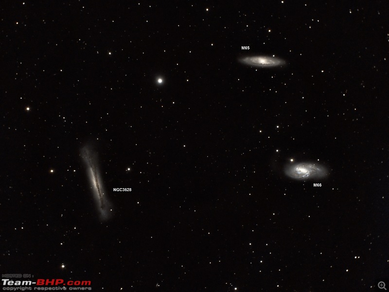

Leo Triplet, Hercules Globular Cluster and IC 4617
Once the setup was ready, got a couple of clear nights and managed to shoot a couple of targets.
The Leo Triplet:
The Leo Triplet, or the M66 Group, is a group of interacting spiral galaxies located in the northern constellation Leo. The group consists of the galaxies M65, M66 and NGC 3628, also known as the Hamburger Galaxy. The Leo Triplet lies at an approximate distance of 35 million light years from Earth. The NGC3628 is visible edge on, while M65 and M66 are inclined enough to reveal their spiral arms.
M65 has a diameter of 90,000 light years
M66 has a diameter of 95,000 light years
NGC3628 has a radius of 100,000 light years
This picture is an integration of 68 images each with an exposure time of 3 minutes. That makes it a total exposure time of 3 hours 24 minutes.

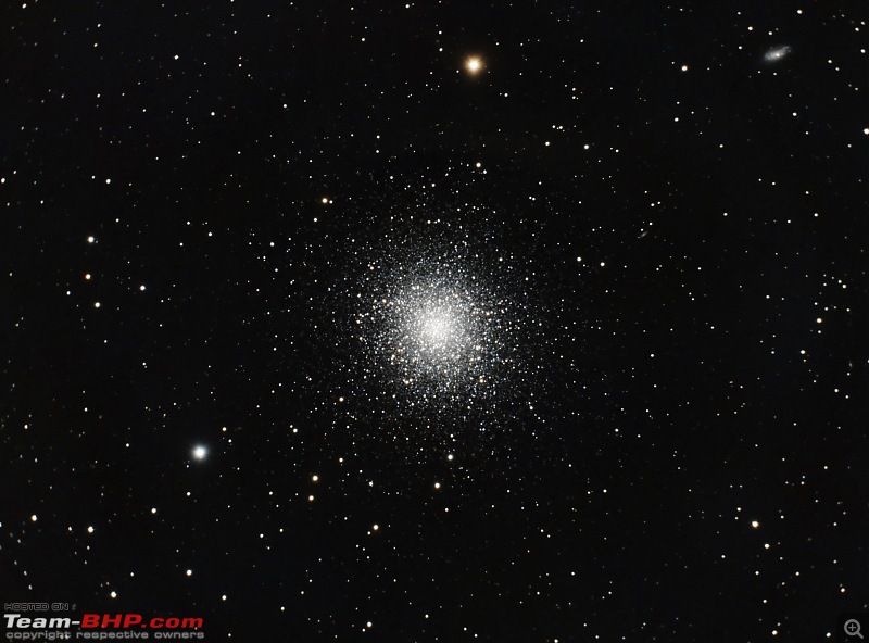

M13 - Hercules Globular Cluster:
Rendezvous with The Universe | My Astrophotography Hobby-m13-hercules-globular-cluster-v1-edit.jpg
Hercules globular cluster a.k.a M13 is a dense cluster of stars packed with several hundreds of thousands of stars in a very small area with a radius of just 72 light years. This cluster is situated at 22,180 light years away from the earth. The age of this cluster is 11.66 billion years.
This picture is an integration of 41 images each with an exposure time of 3 minutes. That makes it a total exposure time of 2 hours 3 minutes. I had posted a picture of this cluster a few posts before. But that was with the smaller focal length and smaller integration time.
Now comes the most exciting part. When I was closely looking at the image of M13, I found two galaxies had photo-bombed the picture. Both these galaxies are on the top right quadrant. One of them is prominently visible and is named NGC6207 and is situated some 36 million light years away from earth.
But the most interesting one is the smaller one closer to the cluster. This one is named IC 4617 and is situated a whopping 500 million light years away from earth. Yes. That is half a billion light years away from earth. When the light that we see today left that galaxy, the first vertebrates were forming in earth's oceans! How humbling can this be!
