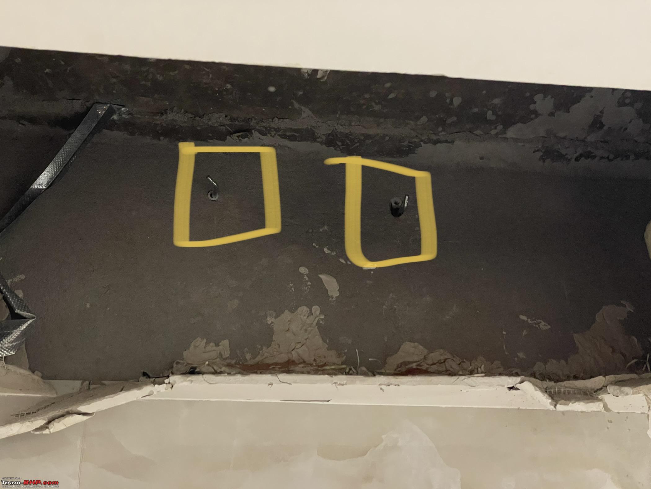

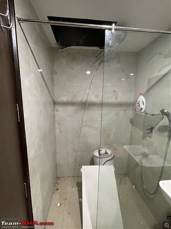

Can a geyser fall off the wall?
So can a geyser fall off the wall? I didn’t know this was possible till two nights ago.
Let’s start with some context. Moved to a new house around March. Had geysers from AO Smith installed (by AO Smith themselves of course) above the false ceiling as marked out by the architect and is the case in every other apartment in the building.
Been using one bathroom this whole time but used the other one for the first time two nights ago.
Geyser turned on around 6:30/7:00 and off by 8:30/9:00. Didn’t get very hot water, luke warm at best.
Heard a crash around 11pm and found the geyser on the floor. Managed to shut off the water and returned to bed (nothing you can do in the middle of the night anyway)
Called AO Smith in the morning, took a while to get them to understand the gravity of the situation but finally had a technician came by around noon.
Not sure if this is relevant but when he released the water out, it was boiling hot. Almost felt like I was in a steam room! Also, the hooks on the wall appear to be undamaged so, did the geyser jump off?
Skip to 24 hours later, the technician is willing to reinstall the same geyser if I pay for new harnesses and pipes. I’m assuming this is the official AO Smith line.
So far nobody wants to identify the problem, they haven’t even opened up the geyser.
1. Is this a manufacturing fault?
2. Is it a design flaw?
3. Was there a lapse in the installation process?
Of course, I’m glad nobody was in the shower when this happened but if the problem isn’t identified, someone somewhere definitely could be when it happens next!
Another concern would be purely architectural - why do they locate geysers above shower areas? Having 40-50 kilos hanging over your head does not feel safe anymore!
Could someone please help me figure out how this happened, AO Smith doesn’t seem interested so I’ve got to decide if I want to put a geyser over my head again

Like you said, glad that no one was injured in the incident.
Two possibilities:
1. The wall is made of hollow-bricks, and hence not able to hold the weight.
2. The screws used were not long enough, and hence the hold was not deep enough.
The pics are not clear enough to check further about #2 above.
Regarding fixing the same again - what would have been the impact to the internals of the geyser due to that fall ? What is the guarantee that there will not be any short circuiting once the same unit is fixed without further checking ? While a check now may not show any problems, but what if a possible fault is like hanging by a thread inside and fails in some time
These are fixed above false ceiling to hide them from view in case of false ceilings. And geysers have been fixed at a high level for ages now, so that the water can also be supplied water thru the shower head. Actually, today's geysers are smaller and lighter than the old ones.

Those seem pretty lame hooks for a geyser tbh. Even the 1 litre geyser in my kitchen has better hooks, rather bolts, on which it rests. The technician should have used proper bolt-screws, video call his boss and ask if what he's installed is appropriate.
Secondly, as condor said, what is the material of the wall. Unlikely that it just can't bear the weight of a geyser (unless it isn't made of bricks but some membrane). Check with others in your society.
Next, and perhaps most importantly, has the installation been done correctly. Since you say you got only lukewarm water but when he let the water, it was boiling. Perhaps, the installation of the control valve was incorrect. Same, with the inlet / outlet pipes being blocked / not fit properly.
Lastly, do check the floor tiles for damage. If the geyser fell on them, there's a good chance, it chipped off tiles. If they're cracked / broken, you could have leakage issues.
This seems to be 100% (installer) technician fault IMO.

That is a scary scene. Those hooks look like picture hangers! What capacity heater is it?

So the interesting thing is, the hooks are still in the wall … undamaged and unmoved

That is pretty scary. Gives me shivers to imagine this happening while someone under the shower - could get electrocuted, burnt and physically injured all at same time. I'd surely check all my geysers to be sure.
Fastening has clearly been done in the most lame way possible. Typically these are hung using fasteners and not ordinary screw/bolts. These fasteners are wedged and expanded into the bore in wall to actually claw the wall surface.
Glad to know no one was injured.

The right side hook has definitely moved (notice it's cut and slipped out of its plastic retainer). The installer likely drilled the RHS hole larger, but installed the same sized retainer. Giving it a shake when unloaded, it probably looked tight enough, but gave way slowly over time when carrying the loaded geyser.
Please get a competent installer.

As others have pointed out, It clearly looks like a substandard/cheap installation. Even The penetration of the hooks looks dicey. Tell the same guys to install it properly with standard nut/bolts depending on the capacity/weight of the geyser.
Check yourself if those hooks are loose or moving with your fingers. I bet they would be.
