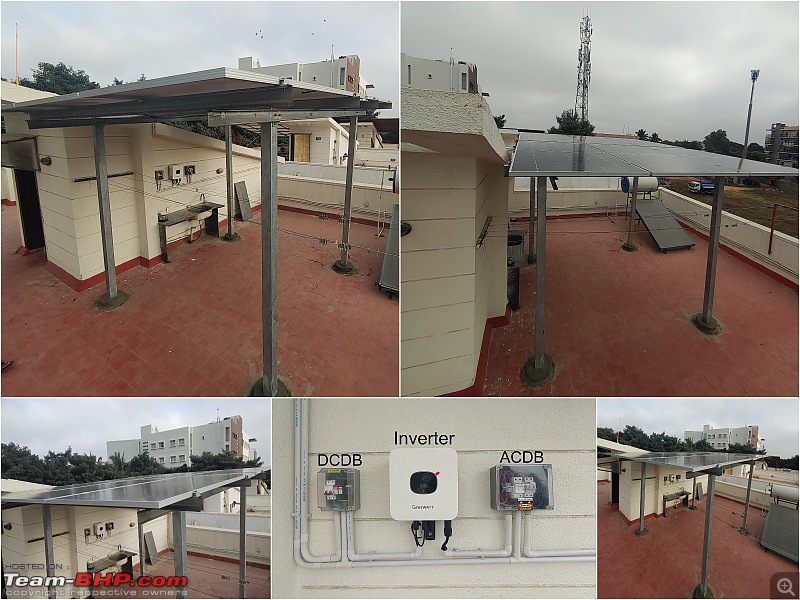

10 Bifacial panels of 395 kWp each (total 3.95 kWp) installed in 2 rows of 5 columns on a standalone frame with wood composite cladding and watertight roof mounting. Produces up to 460 units per month with a South facing slope of ~8.5°. Cost per kWp is more than ₹1,00,000.

  • Complete installation and commissioning, including full coordination with BESCOM and handling all paperwork.
  • DC, AC distribution box and Single phase string inverter to be kept on terrace
  • Lightning arrestor
  • Three earthing pits, one each for lightning arrestor, AC and DC
  • Solar generation meter next to LT panel
  • Replacement of current BESCOM meter with net metering meter given by BESCOM
  • App based monitoring
  • 1 year AMC

Wonderful and in-depth analysis. however the costs seem to be much higher than what I have seen.
I installed 11 KW on-grid solar panels plus inverter on my rooftop in July 2021@ 46,000 per KW all inclusive. I went for a south facing installation, as is the norm here in Delhi NCR. I opted for a stilt installation to have the usable space underneath the panels.
Here are my observations (without detailed tracking)
  1. I have seen the power generation touch a max of 7.5KWh, mostly it hovers around 6.5KWh at the peak time
  2. my monthly bill in summers was around 10K, while in winters was about 4K - this has gone down to ZERO! I only paid around 2K for a month when the usage was very high
  3. Total yield as per the tracking app is INR 1.85 Lakh so far, in 20 months of operations.
  4. The rough breakeven is likely in 4.5 years, sooner if tariffs rise
  5. the thermal insulation is significant as the solar panels do not let through any light
  6. Although the raised installation allowed me to have usable space under the panels, the cleaning becomes very very difficult. In our climate the cells start showing significant dust accumulation within a week.
