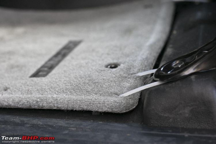

Now, this is why its very important to have driver side mats, which have locks in them. They prevent from moving forward, which is a tremendous risk!!
If there is no lock, please install one.
Atleast tag it like this:
Pic Source: Our Tundra Zip Tie Experience -- Toyota's Floor Mat Fix | Used Vehicles Blog & Discussions at Truck Trend Magazine
