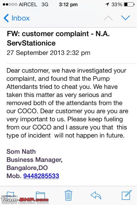

This is what I hear from IOCL. I replied back saying I will report this to the ministry of petroleum also as there would be others also who would be aware of this. Why make these 2 attendants as the scapegoats

This is what I hear from IOCL. I replied back saying I will report this to the ministry of petroleum.
Good to see that IOCL has responded to your complaint. What we don't know is whether they have actually taken action or not. Only you can confirm this by visiting the outlet multiple times.
Now let us see whether our Babus will hear your plea or not.
@speedsatya, Now that IOCL has acknowledged their error and apologized for the same, why not take them to task by filing a complaint in the consumer court? I personally feel that we should teach them strong lessons that as consumers, we are serious against any fraudulent things happening and not 'chaltha hai' attituded person.
What say??

For some reason, I find it difficult to trust all IOC petrol pumps. Long time back in around 2002-2003, when we had our Santro, I was cheated too at an IOC petrol pump near our house. When asked to fill petrol worth 500/- he filled only about 400/- worth of fuel. Sadly at that time, I was naive and didn't realise it till very late However since that incident, I never fill at any IOC bunk. Pune members will know it as the IOC pump near Nal Stop; never ever filll up at that bunk. Those guys are crooks at this particular pump. Instead go to the BPCL petrol pump next to it, or to the HP petrol pump on the opposite side of the road.
EDIT: Good to see that action was taken on your complaint. But on second thoughts, removing the attendants from service is only the corrective action; are they going to do any preventive action as well? Remains to be seen!
Thanks speedsatya for the updates.
Sadly I trusted this place for several years! Little did I know they would turn into crooks!
I stopped frequenting this place because I found it hard to deviate from my work route. But after I read your post, I wanted to check again for myself and guess what? Old habits die hard! I pulled over for a pitstop in my VW Polo and asked him to fill diesel for 500 bucks. No sooner I opened the fuel cap, the attendant was accompanied by some sales guy selling some holiday card. At the first instance, I politely refused whilst keeping an eye on the attendant's movements. After a few seconds the sales guy tried to intensify his pitch almost trying to block my view of the dispenser. At this point I had to give him a piece of my mind and yelled at him! And then he moves away. All the while keeping an eye on the dispenser and the attendant!
I said "Boss I know all your tricks so becareful and don't mess around!" in Kannada to both of them! Lol
Mind you, all this happened in less than 15 seconds! My my! These days just refuelling needs a lot of effort, attention, alertness and adrenaline!
Anyway, I've made up mind too. They've lost a long time customer!
