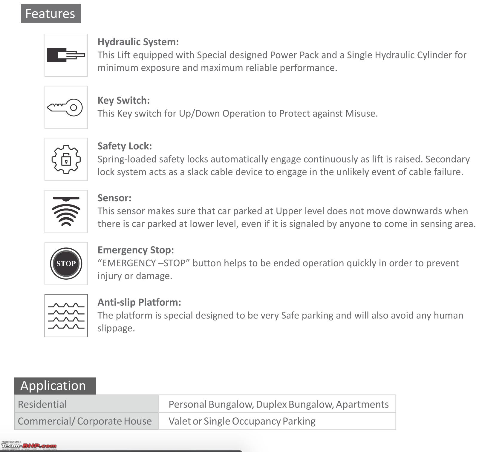

This is from an Indian brand (GJ Based), Patson hydrotech (patsonhydrotech.com). Looks like a very neat and simple solution.
Advice needed: Twin-Parking System in my building?-screenshot-20200612-11.30.11-pm.png
Both the spec sheets are attached below:

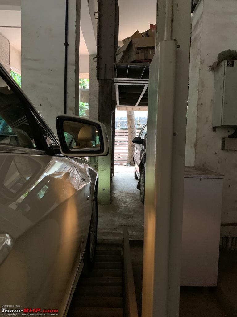

I got my twin parking system changed in my parking lot from one given by the builder to Wohr Parklift 411/5. It has Load per platform max. 2000 kg (load per wheel max. 500 kg). Installed it in 2017 at the cost of Rs 2 lacs approx and so far its working fine and I'm satisfied with it. First year servicing is free, servicing is done every 3-4 months, there is an AMC as well for the same and Ive availed it.
Few things you should keep in mind :
- Make sure the base is strong ( Hard concrete ) where they can drill the holes for pillar.
- Enough drive-way before the parking system so that the car is dead straight when you load it on the platform.
(I don't have that privilege, every time I park any car I have to lift the platform and take advantage of place below the platform)
- Mark the position on the pillar for different cars.
(I use my parking system with Innova Crysta and E-Class (W212). Parking the W212 on top is not an issue but with Innova I've to be very careful that I don't hit the ceiling or pillar.)
- Make sure you have enough space around the parking system for hydraulic lines, wires and switch.
Attaching few pictures for reference.

Gap between pillar and mirror. (I could open the door till first notch)
Advice needed: Twin-Parking System in my building?-5.jpg
