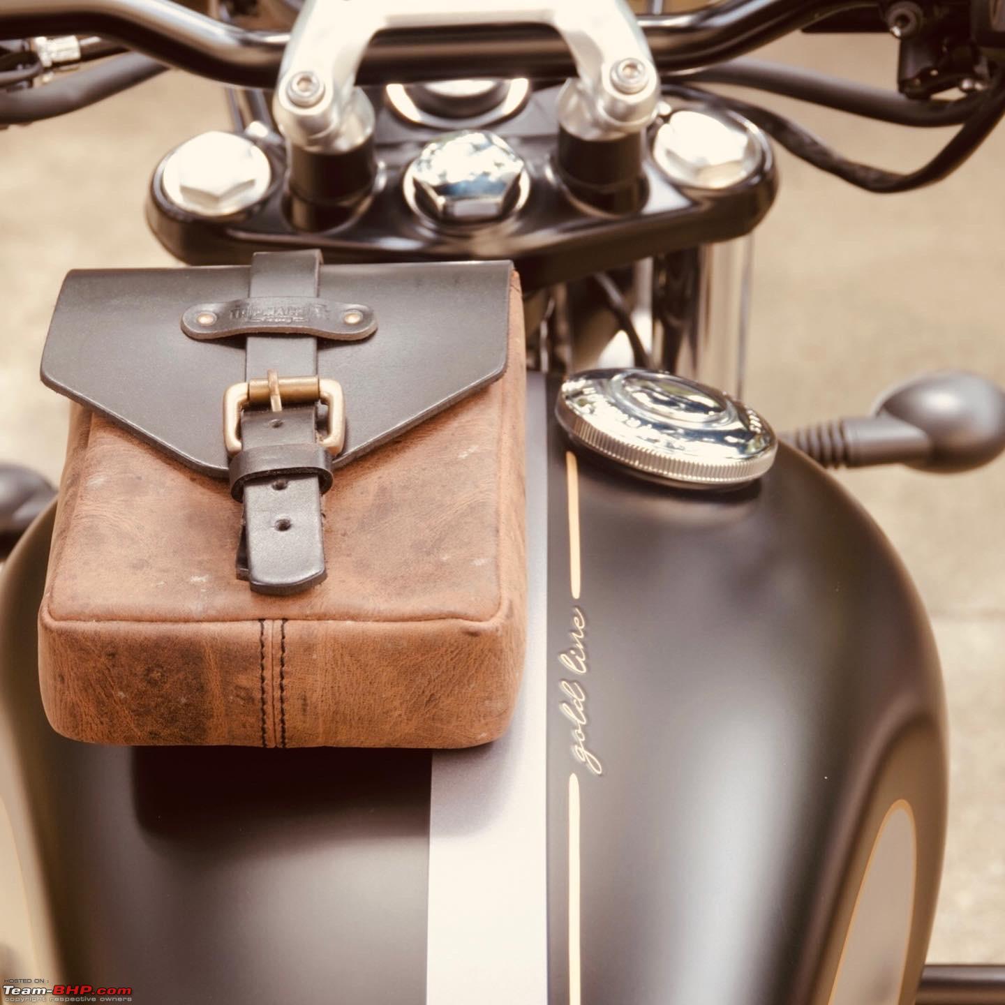

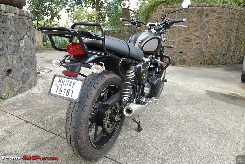

Adding Luggage accessories...
Finally got around to mount the Luggage accessories as follows:
Top Rack with baseplate (ZANA)
Saddle stays (Motone UK - Ordered from Motousher)
Saddle bag (Tripmachine)
Tank pouch (Tripmachine)
The Top Rack & Saddle stays mounting
Review: My Triumph Street Twin Gold Line Edition-rack-stay-install.jpg
Review: My Triumph Street Twin Gold Line Edition-rack-stay1.jpg
Review: My Triumph Street Twin Gold Line Edition-rack-stay2.jpg
Review: My Triumph Street Twin Gold Line Edition-rack-stay3.jpg

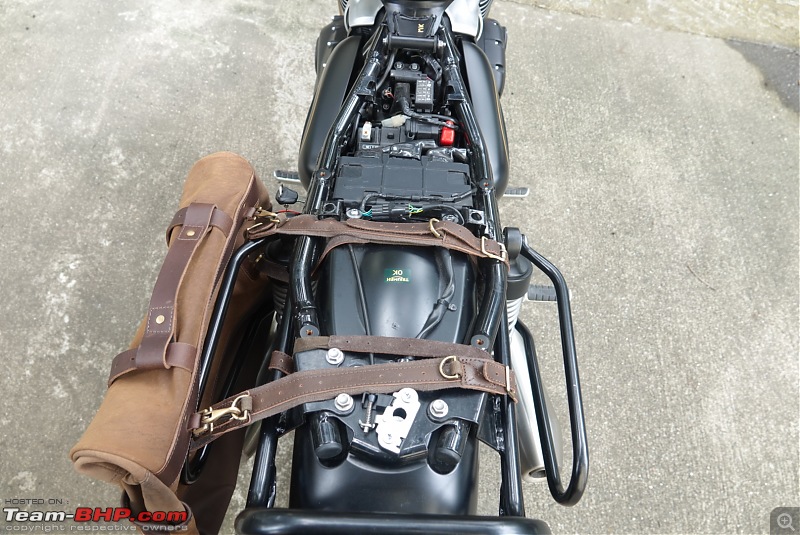

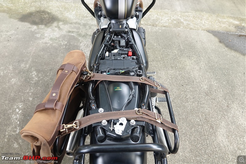

The Saddle bag mount - As per Tripmachine install video
Review: My Triumph Street Twin Gold Line Edition-saddlebag1a.jpg
Review: My Triumph Street Twin Gold Line Edition-saddlebag-2a.jpg
Review: My Triumph Street Twin Gold Line Edition-saddlebag-3a.jpg
Review: My Triumph Street Twin Gold Line Edition-saddlebag-stay-4a.jpg

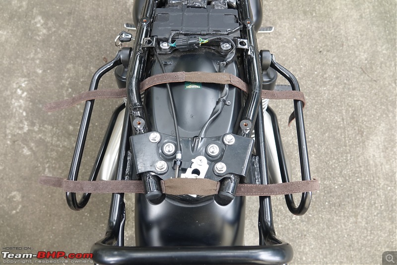

Was not too happy with the exposed straps on the seat & also thought that it would bother the pillion (In my case would be the Mrs!!)
So decided to explore available options and use the rack & the saddle stays to the maximum potential:
The Saddle bag mount - Optimised
Review: My Triumph Street Twin Gold Line Edition-saddlebag-1b.jpg
Review: My Triumph Street Twin Gold Line Edition-saddlebag-2b.jpg
Review: My Triumph Street Twin Gold Line Edition-saddlebag-2c.jpg
Review: My Triumph Street Twin Gold Line Edition-saddlebag-2d.jpg
Review: My Triumph Street Twin Gold Line Edition-saddlebag-2e.jpg
Review: My Triumph Street Twin Gold Line Edition-saddlebag-final.jpg

As of now have ensured that there is a sizeable gap between the upswept exhausts, saddle stays are ensuring there will be no risk of contact with tyres while riding.

Just a thought: When you load the saddle bags, there are chances that it will touch the exhaust and get damaged? Any redundancy for this? Will the heat from the exhaust damage the bottom of the bag? May be take a few rounds and then touch the bottom of the bag and feel it yourself?
Oh absolutely… that’s the one risk I need to figure out during the rides. The other one about friction with the tyre has been mitigated by saddle stays.
Will be carrying stuff in the saddle bags to see how it fares. One of the advantages of mounting it by running the straps over the seat is that it raises the resting position of the bag allowing for more gap between the exhaust and the bottom of the bag.
Will share my experience in the days to come.

Please be very carful in running through any strap under the ST seat the mounts are not strong and do break easily. As a former owner learnt this the hard way, with a pillion the seat flexes and the clearance we see with the seat taken off is eaten away specially with buckles and loops.
Bench seats costs a cool 30K!
the bag looks good, unsure of the clearance though. Ride safe.

  • Saddle bag - User experience & learnings
Very functional for the usual trips around the city. Very useful to pack the bike cover.
As described above, the saddle bag can be mounted a) As advised by the Trip machine brand (straps over the seat) or b) self proclaimed (Optimised with straps below the seat)
For the Street Twin with the upswept exhausts the 'Optimised' is NOT advisable if you have a pillion riding with you. The reason being that the saddle bag almost touches the pipes & you risk it getting damaged.
So I stand corrected and would recommend it to be installed & used with the conventional mounting (straps over the seat). Now comes the question.. do the straps bother the pillion, well its relative!! (If the relative is the wife then yes it does). For all other relatives one can just ignore

Your observation on the bag touching the pipes was absolutely 'on point'. Have mitigated it by running the mounting straps over the seat & thus raising the bag and increasing the clearance with the pipes! Thanks for the heads up!

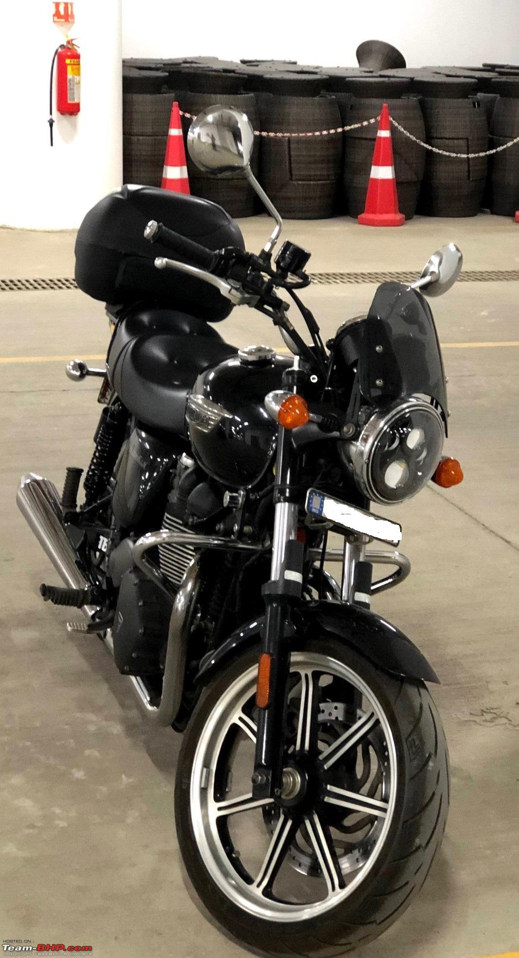

So a huge shout out, if anyone has had any experience of them or friends having used any wind screens on the Street Twin, please do share. Will help a lot
Not on the Street Twin, but on my Bonnie. I would imagine the experience would not be much different. I have used the Dart Flyscreen and also the Triumph OE Touring screen on my Bonnie. I would say both are pretty useless when it comes to wind protection. Even with the large Touring screen I'm able to get wind and noise protection only if I crouch and no way in my normal riding position which is a shame. You would really need a huge one to offer you that kind of protection while riding in the normal position. So, I've gone back to my flyscreen as it at least gives it a good look.
So, before investing, I would suggest you try out some screens (if there is a possibility), as otherwise, it might end up being an unnecessary luggage either on the bike or at home. Couple of photos of my bike with the flyscreen and the Touring screen
