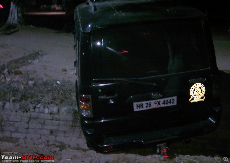

We scorpio owners are a funny lot. Love our rides & people connected with it more than anybody else. Devdath got married recently and who does he visit with his better (will turn bitter later) half first? No, no; not any of his relatives etc., but to my FNG. And believe you me, it was not to get his truck checked but to show the new accessory... Lol.
There he mentioned to Rakesh about The Bull's new HLs. Rakesh (FNG) called me up, remonstrated with me for not telling about this to him first and said that I must visit him today itself to show the new fitment. So, in the evening while returning home from work I landed up at my FNG. The new HLs were thoroughly inspected, wiring connections checked, light throw observed and the verdict pronounced was - "awesome, I too will fit the same in my Scorpio". With my toungue firmly in cheek, I jovially mentioned - "nazar utaarnee padegi". Little did I know that shortly after the "nazar" would affect The Bull.
After exchanging pleasantries with Rakesh, I headed to the DLF Phase I Market, Gurgaon enroute to home to pick up some stuff, forgetting that being Tuesday it was the weekly off for the market. The normally overcrowded parking space was almost empty and this cockled my heart. I proceeded to park and with the "nazar" working full-time coupled with an error of judgement, I parked in a deep dry nullah with the left rear wheel precariously suspended in air and the right rear wheel barely on the ground. Kicked myself you-know-where and then put on my thinking cap.
Mahindra Scorpio : Issues & Solutions-06122011021.jpg
Inspected the whole scenario and surmised that with the help of a 4x4 vehicle The Bull could be pulled out. Two people immediately came to my mind - Roshun & Shamindra (SS-Traveller). Both own a 4x4 Scorpio. I also had in the meanwhile mentally shortlisted my known rescue crane operator.
Placed a call to Roshun and luckily for me he had just returned home and was parking. I explained the scene and requested him to come if possible. He readily agreed but said that he didn't have the tow-rope. I told him not to bother as I always carry a 5 ton tow-rope with D-shackles in the boot. I also called up the crane operator to be on stand-by in case The Bull could not be pulled out by Roshun.
At 8:30 pm The DesertFox, with several rescues under its belt, arrived. It was positioned, tow-rope attached, both the engines started, The Bull on 1st gear and the Fox on 1st gear +4L, engines revved to 3k RPM and with the hoot of the Fox both the clutches were released simultaneously. Without even a burp & bump The Bull rode out of the nullah.
A BIG THANK YOU ROSHUN & FOX.
There wasn't any apparent damage to Bull's underbody as I had reversed very slow and the pintle hook took the load and held tight. Relieved Roshun & I left for home.
