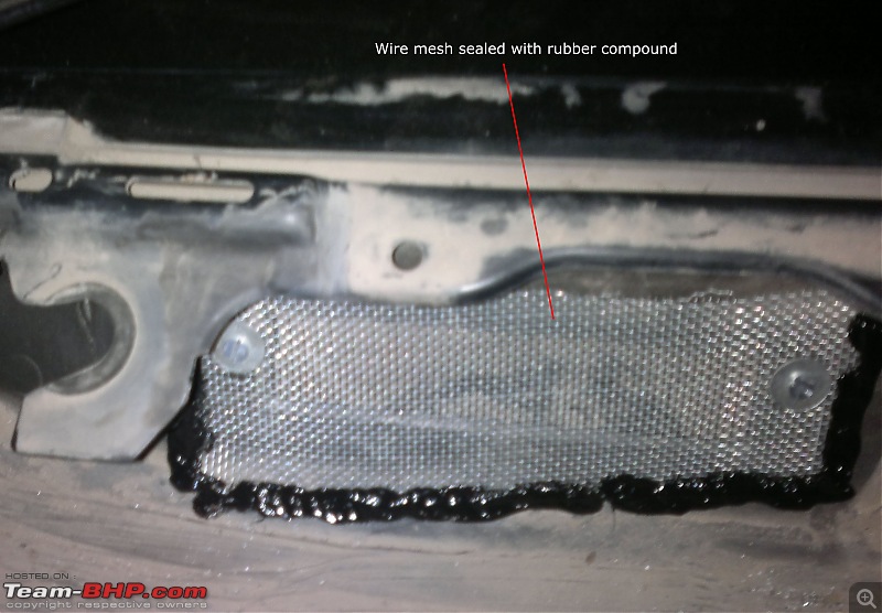

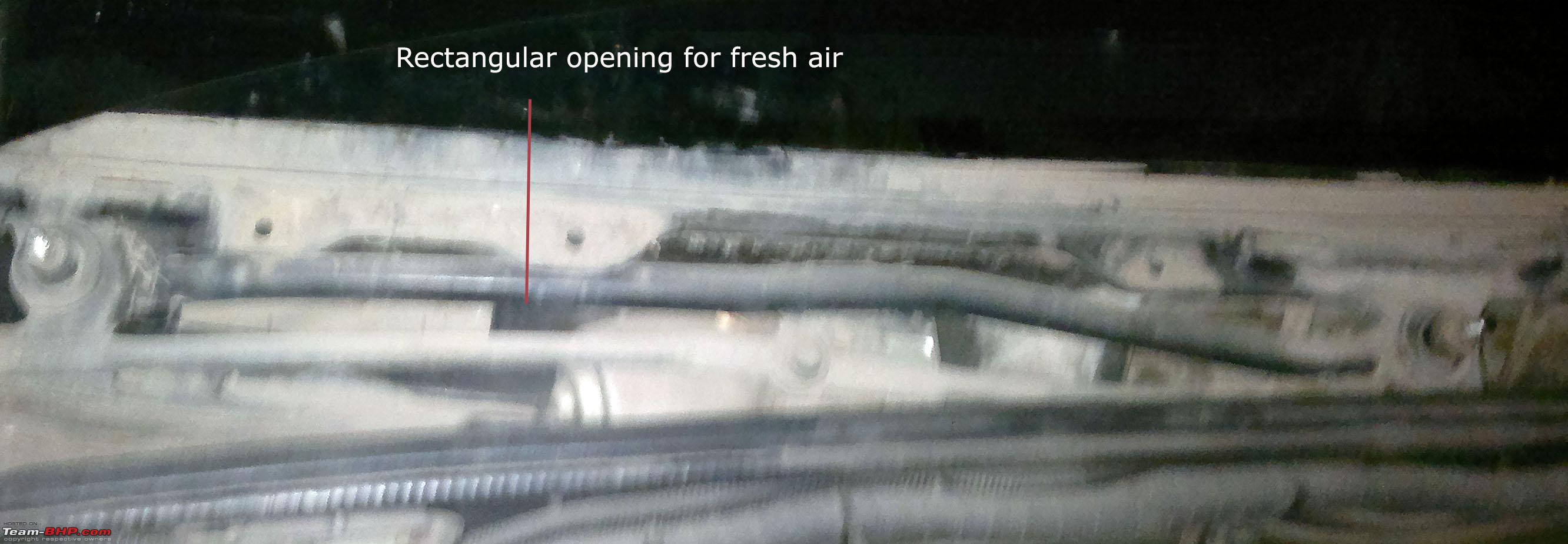

Rodent menace & permanent solution..
As the title suggests, a lot of members here have suffered this at some point of time. I had a nasty ordeal in 2008 and you can read all about it here - http://www.team-bhp.com/forum/travel...r-gurgaon.html.
Various cures & solutions have been posted here over so many years but nothing has been permanent. Very recently a friend Devdath from B'lore had a rodent attack. This south-indian rodent proved to be a very enterprising critter. Loved the rat poison and digested it after ingesting. To cut the story short, Dev decided to do something about it and after some research found out that the only way a rodent could enter the cabin was through the fresh air inlet. Now, there are four fresh air inlets located outside just beneath the wipers and covered by a plastic/fiber mesh, that incidentally is open at both ends. These inlets are the only source of entry inside the cabin and through the left-right opening on the fiber grill, any small creature be it a snake or a rodent can enter inside the cabin.
Mahindra Scorpio : Issues & Solutions-13122011028.jpg
Mahindra Scorpio : Issues & Solutions-13122011029.jpg
Mahindra Scorpio : Issues & Solutions-13122011030.jpg
Dev decided to close those 4 inlets with a hard fine wire mesh that would prevent any unwanted entry but allow fresh air. He got this done on Monday the 12th at the shop of my accessories dealer. Manoj, the chief troublemaker, did a perfect job. I too was there with Dev while the work was going on and made a mental note to get the same done on The Bull.
Mahindra Scorpio : Issues & Solutions-13122011032.jpg
Mahindra Scorpio : Issues & Solutions-13122011033.jpg
An excellent idea and seems very well executed. Thankfully we in Navi Mumbai do not have that much a menace in terms of rodents but still is a good idea to have these inlets closed.
