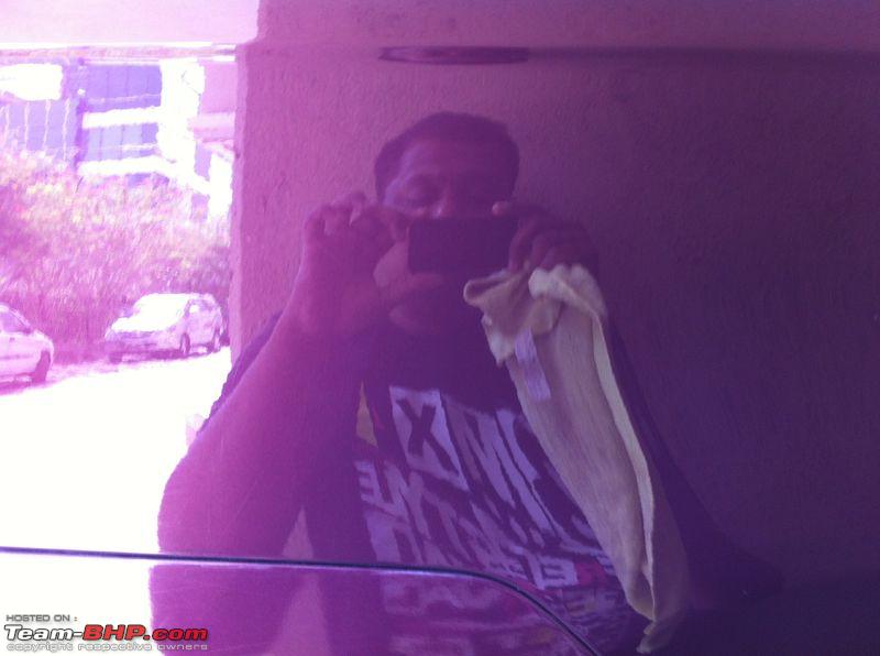

4. Gave the surface a clean with onr blue one. Just to remove some dirt. But should I've done this in the middle of the process? Since I don't even have a polish with me. Please advise.
5. Waxing with collinite 845 plus pinnacle foam pad plus jopasu magic wipe
I found the pinnacle foam pad to be better than meguiars because of its size and thus being easier to maneuver. But the price is 3 times that of meguiars so I'm keeping this single pad just for wax applications.
Due to the light color of my car I knew I couldn't expect mirror like reflections but what did improve with collinite in a single coat is how the finger just glided over and it felt very slick to touch. Gave a second coat too about 2 hours later as I had to go off for some work in between. This slick nature I feel Is what is going to let the water bead and also very easy to clean dust off with a simple wipe.
All in all, what I realised is car detailing is a much more fun process than doing a bike as the area covered is larger and the results are more prominent. But I've a lot of learning to do in this regard as I've just started.
I wanted to check the beading today but did not get time. Will try out tomorrow.
My clay stock is running short and I soon may have to turn to notorious for his OEM bars. Notorious sir can you pm me the details how to go about ordering your bars plus the prices.
Feedbacks are welcome :please:
